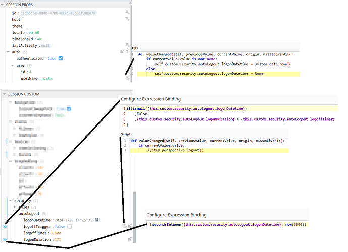

I want to display a countdown timer on one of my perspective view.
For eg. as soon as a user logs-in I want to display a countdown timer for 1hr. Is there any way I can achieve this ?

- Create a session custom property, `countdownStart`.
- When the user logs in run the following code in a script:
```auto
	self.session.custom.countdownStart = system.date.now()
- On your countdown label create an expression binding to calculate the time remaining. For example,
`floor((now(1000) - {session.custom.countdownStart}) /1000)`
will tell you the number of seconds since countdownStart.
- Modify the expression to give the number of seconds remaining.
- Modify the expression to clamp the time remaining at zero (to prevent it going negative).
- Modify the expression to give the time remaining in mm:ss format.

**Post date:** [January 27, 2024, 1:25pm UTC](https://forum.inductiveautomation.com/t/timer-clock-perspective/84843/10 "2024-01-27T13:25:37Z")
That's better.
Add the code into Project Browser → Perspective → Session Events → Page Startup.
You might also go back through some of your other threads and see if any of the problems were answered to your satisfaction. As far as I can see you haven't marked any of the answers as 'Solution'.
**Post date:** [January 28, 2024, 6:30pm UTC](https://forum.inductiveautomation.com/t/timer-clock-perspective/84843/11 "2024-01-28T18:30:12Z")
> [@Transistor](#):
Not sure about this. I would be putting a value change event handler on the session.props.auth.user.userName to set the custom session prop

**Author:** ![Vatsal\_Shah](https://avatars.discourse-cdn.com/v4/letter/v/0ea827/32.png) [@Vatsal\_Shah](https://forum.inductiveautomation.com/u/Vatsal_Shah)\
**Post date:** [January 29, 2024, 5:58am UTC](https://forum.inductiveautomation.com/t/timer-clock-perspective/84843/14 "2024-01-29T05:58:45Z")
I was wondering, will "putting a value change event handler on the session.props.auth.user.userName to set the custom session prop" will work if the same user logs in again?
Asking this because i'm building something like : every one hour the user need to log in again.
**Post date:** [January 29, 2024, 6:03am UTC](https://forum.inductiveautomation.com/t/timer-clock-perspective/84843/15 "2024-01-29T06:03:09Z")
It will run whenever the userName changes
**Post date:** [January 29, 2024, 6:07am UTC](https://forum.inductiveautomation.com/t/timer-clock-perspective/84843/16 "2024-01-29T06:07:29Z")
Can you post a step-by-step solution pls.
**Post date:** [January 29, 2024, 6:18am UTC](https://forum.inductiveautomation.com/t/timer-clock-perspective/84843/17 "2024-01-29T06:18:32Z")
Something like this:
 ![image](https://us1.discourse-cdn.com/inductiveautomation/original/3X/2/b/2beb9904d3175f960d97e14e7edf35db7571d82f.png)
The logout doesn't work atm as I think you need to pass in the session id... but I always forget how to do this
