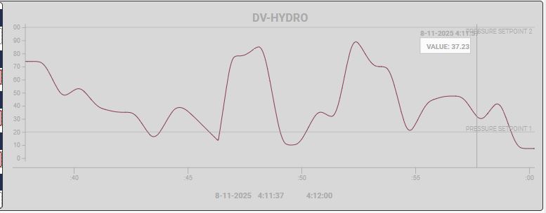

Hi everyone,
I'm new to Ignition and currently working on a project involving a hydrotester. I have a dataset tag that stores time-series data: the X-axis represents the timestamp when the start button is pressed, and the Y-axis records the testing pressure.
I’m using two Timeseries Charts:
- One in my **Perspective Template Overview**
- One in the **Reporting Module**

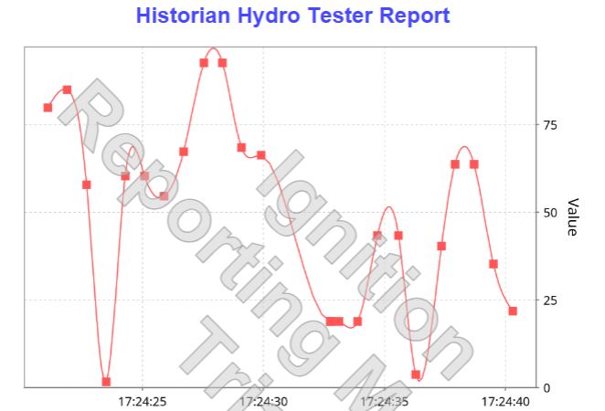

Both are bound to the same dataset tag. The chart in the Perspective Overview displays a **smooth curve** , which is ideal. However, the chart in the Reporting Module shows a **step/ramp function** , which doesn’t reflect the actual pressure behavior accurately.
Here’s a summary of my setup:
- The dataset tag is updated via a Gateway Timer Script.
- The script appends new data points (timestamp and pressure) to the dataset.
- I keep only the last 100 points to manage performance.
Here’s the relevant part of my Gateway Timer Script:

Timeseries Chart: Overview
 ![Overview](https://us1.discourse-cdn.com/inductiveautomation/original/3X/f/6/f629931a4e18d55d65c5402ef5f6c1d5446255d0.jpeg)
Timeseries Chart: Report
 ![Report](https://us1.discourse-cdn.com/inductiveautomation/original/3X/3/0/3043ab5bc00d779cae03af06bbf0bd51d60717fc.jpeg)
**My question is:** Is there a way to make the Timeseries Chart in the Reporting Module display a **smooth curve** , similar to the Perspective component with interpolation? Or is there a workaround to achieve a similar visual effect?
Any guidance would be greatly appreciated!
Thanks in advance,
Kemmone
**Author:** ![Ryan\_Deardorff](https://sea1.discourse-cdn.com/inductiveautomation/user_avatar/forum.inductiveautomation.com/ryan_deardorff/32/63815_2.png) [@Ryan\_Deardorff](https://forum.inductiveautomation.com/u/Ryan_Deardorff)\
**Post date:** [August 11, 2025, 3:28pm UTC](https://forum.inductiveautomation.com/t/timeseries-chart-perspective-component-vs-reporting-module/109590/2 "2025-08-11T15:28:05Z")
Enable scripting on the chart:
 ![image](https://us1.discourse-cdn.com/inductiveautomation/original/3X/0/4/04c205834b59b58348f53cf5bcef295ab6b053fe.png)
Then:
```python
def configureChart(data, chart):
	from org.jfree.chart.renderer.xy import XYSplineRenderer
	plot = chart.getPlot()
	renderer = XYSplineRenderer(8)
	plot.setRenderer(0, renderer)
That will add shapes to each plot point, but you can remove those:
```python
for i in range(plot.getSeriesCount()):
	renderer.setSeriesShapesVisible(i, False)
**Author:** ![Kemmone\_Botshoma](https://avatars.discourse-cdn.com/v4/letter/k/f0a364/32.png) [@Kemmone\_Botshoma](https://forum.inductiveautomation.com/u/Kemmone_Botshoma)\
**Post date:** [August 11, 2025, 3:49pm UTC](https://forum.inductiveautomation.com/t/timeseries-chart-perspective-component-vs-reporting-module/109590/3 "2025-08-11T15:49:34Z")
Using this script
> def configureChart(data, chart): from org.jfree.chart.renderer.xy import XYSplineRenderer plot = chart.getPlot() renderer = XYSplineRenderer(8) plot.setRenderer(0, renderer)
This is what I get. Thank you very much. This is much better.
 ![NewGraph](https://us1.discourse-cdn.com/inductiveautomation/original/3X/7/4/7403c8d7ba88bb8cc8f5cfed4b46769bf1f2e5e3.jpeg)
