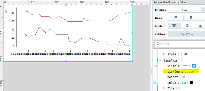

I’d like the timeseries chart to be screen size responsive.
Setting x-axis tickCount to auto does not work as expected. That is, number of ticks will be same number regardless chart width is big or small.
 ![image](https://us1.discourse-cdn.com/inductiveautomation/original/3X/c/a/cab38d499e88def320e2807a27045e5a9ec291de.png)
Any way to get around this?
Best if it is smart to auto adjust according to length of dates.

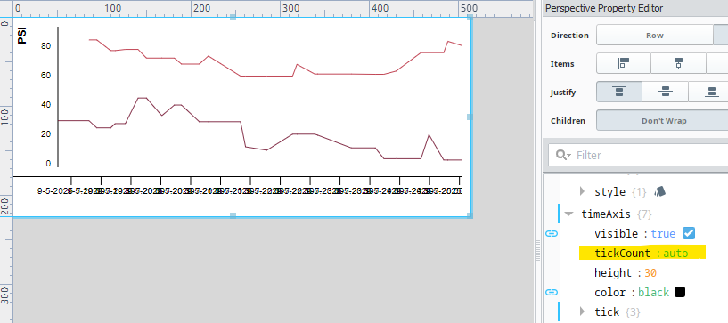

Two things you could do come to mind:
- Format the date to be shorter (truncate or drop the year altogether)
- Make the labels angled:
