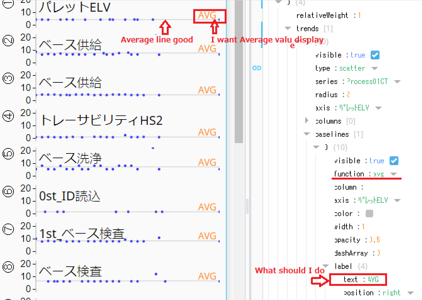

I'm japanese English a bit
TimeSeriesChart I want to know how
 ![image](https://us1.discourse-cdn.com/inductiveautomation/original/3X/f/4/f46df5bc4ea3b8df9c8ac5a67a4836bcdca644de.png)
Do you understand my question?

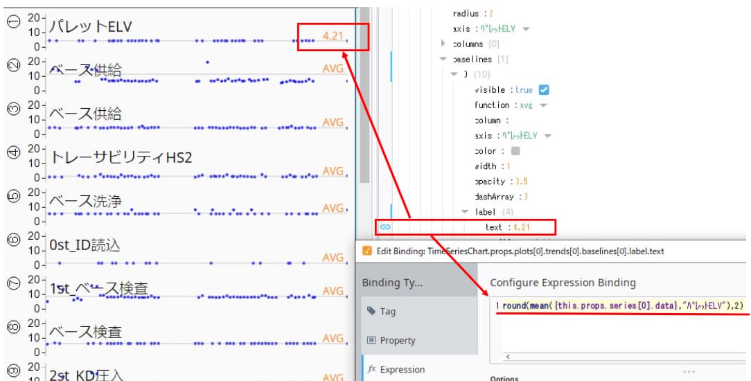

**Author:** ![ryouichi\_taniguchi](https://avatars.discourse-cdn.com/v4/letter/r/6a8cbe/32.png) [@ryouichi\_taniguchi](https://forum.inductiveautomation.com/u/ryouichi_taniguchi)\
**Post date:** [March 25, 2024, 12:43am UTC](https://forum.inductiveautomation.com/t/timeserieschart-baselines-average-value-display-means/87313/2 "2024-03-25T00:43:12Z")
Resolved
Thanks guys
 ![新しいビットマップ イメージ](https://us1.discourse-cdn.com/inductiveautomation/original/3X/6/f/6fec30414174c90f72803939b4ad6a7b5161fee4.jpeg)
