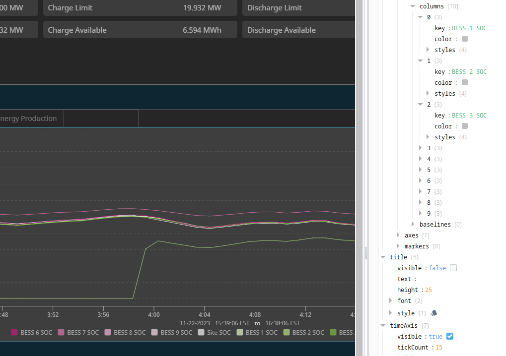

Your solution worked great for the first 8 coulmn entries. Thereafter, when I add another the sort order goes random again. I have confirmed my dataset column entries are correct, and matches the column key. Any thoughts on what could cause this behaviour?

I have this issue when showing 8+ trends as well.
