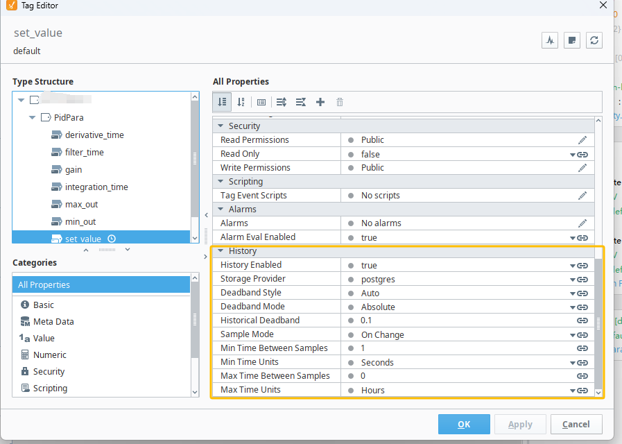

In Perspective TimeSeriesChart, tag value not change , how to set ,let it show a straight line?
Tag SV - IN two minutes not change ,always equal 67.
But in chart ,it shows not a straight line.
How to set its property?
TimeSeriesChart display:
 ![image](https://us1.discourse-cdn.com/inductiveautomation/original/3X/5/2/5218e81cc5de97d41446fdc7cf4422a93d828149.png)
TimeSeriesChart Binding:
 ![image](https://us1.discourse-cdn.com/inductiveautomation/original/3X/6/6/668d620052e7645d0f73d258a6a32efbaf8996d8.png)
 ![image](https://us1.discourse-cdn.com/inductiveautomation/original/3X/e/5/e5750c06d147ba7875b36328faee3bc4d9b5a1a1.png)
Tag history setting:
 ![image](https://us1.discourse-cdn.com/inductiveautomation/original/3X/2/5/25751a879c10754d4768bdda65ee75f1596e25eb.png)

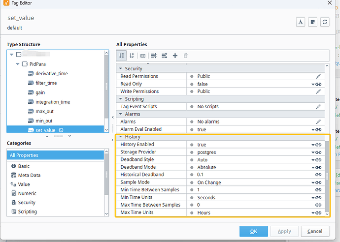

**Author:** ![martin.johansson](https://avatars.discourse-cdn.com/v4/letter/m/7feea3/32.png) [@martin.johansson](https://forum.inductiveautomation.com/u/martin.johansson)\
**Post date:** [October 24, 2024, 4:59am UTC](https://forum.inductiveautomation.com/t/timeserieschart-tag-value-not-change-how-to-set-let-it-show-a-straight-line/97700/2 "2024-10-24T04:59:32Z")
Try setting "Deadband Style" to "Discrete". This will only work with the new data that is saved after the change.

Yeah, Thank you !
Tag Hisotry Deadband Style set to Discrete: The value will not be interpolated.
 ![image](https://us1.discourse-cdn.com/inductiveautomation/original/3X/2/d/2daa557cc17a7a2173068b9a444c75400433b8ec.png)
The deadband will be applied directly to the value. That is, a new value (V1) will only be stored when: |V1-V0| \>= Deadband.
