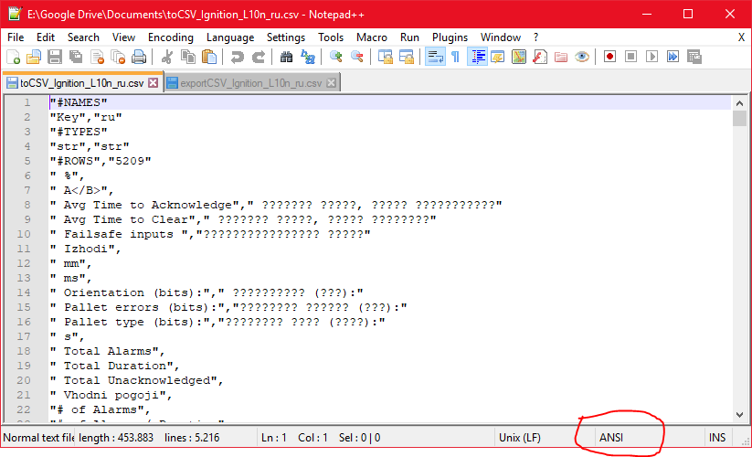

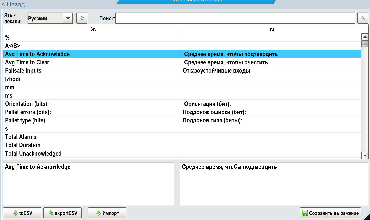

When I use system.dataset.toCSV to export Russian translations from table
 ![translationTable](https://us1.discourse-cdn.com/inductiveautomation/original/2X/0/01aad9ed4bfeee43b91e94a396ff16341e7b5c7c.png)
to .csv, I get this:
 ![toCSV](https://us1.discourse-cdn.com/inductiveautomation/original/2X/c/cec965d1d70b6e6b0aa1f56ad47afd8ed91cdad6.png)
When I use system.dataset.exportCSV, I get this:
 ![exportCSV](https://us1.discourse-cdn.com/inductiveautomation/original/2X/0/01345f4edb72521247b7f156a4240eb3270d6e8d.png)
To import csv there’s only one function: system.dataset.fromCSV, which requires csv format from .toCSV.
But that file doesn’t have Russian text, but only ???..
So, how can I export and import Russian texts?
