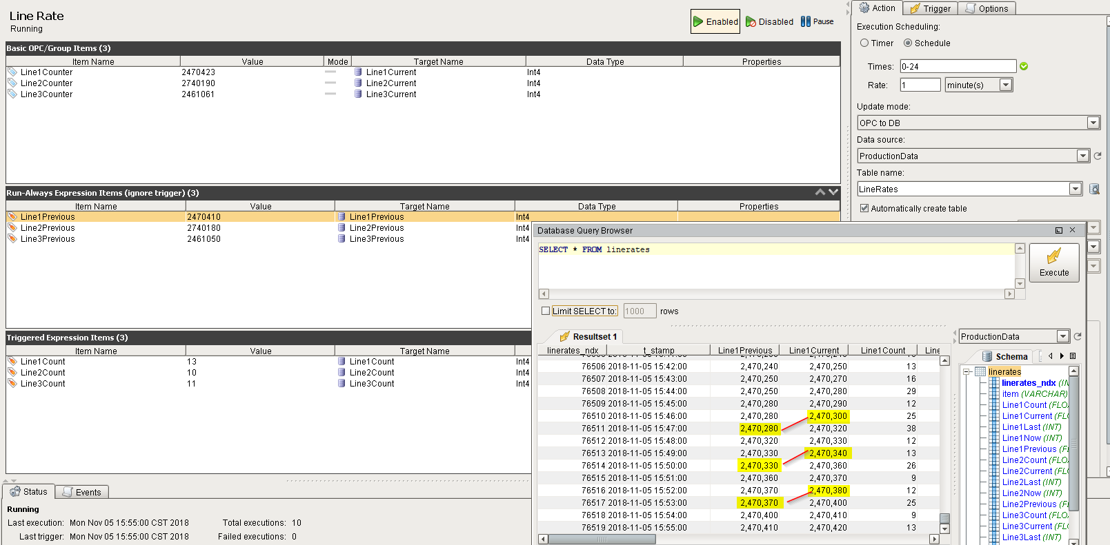

This problem started today. I have a transaction group that is suppose to run every minute.
It has 3 items:
Line#Counter = OPC to counter in PLC
Line#Previous = Run always script
> SELECT Line1Current
> FROM LineRates
> ORDER BY linerates\_ndx DESC LIMIT 1
Line#Count = Triggered Expression
> {[~]Line1Counter}-{[~]Line1Previous}
For some reason every other cycle it is not updating the previous count and the difference for one minute is actually 2 minutes.
Any ideas as to where to troubleshoot this?
 ![](https://us1.discourse-cdn.com/inductiveautomation/original/2X/2/25cb27c355ec560eca6bbb4836cbf6529b3bcfa2.png)
