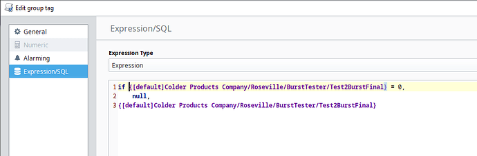

I am working with a transaction group and have everything working perfectly fine, except, if a step in the machines process fails, it logs a 0 to the server. This isn't a total problem, it just makes what we are using the data for a little harder. I started to look into it and found the expression item in the transaction groups and tried out this expression:
 ![image](https://us1.discourse-cdn.com/inductiveautomation/original/3X/9/0/906471ec42092adc412e92b90f010534846c598e.png)
but I am only returning an error.
My goal is to return a NULL if the results are 0, otherwise return the results.
Is there something I am doing wrong within the transaction group?
Is there a better way to approach this?
**Author:** ![Noah\_Casey](https://avatars.discourse-cdn.com/v4/letter/n/e480ec/32.png) [@Noah\_Casey](https://forum.inductiveautomation.com/u/Noah_Casey)\
**Post date:** [May 28, 2024, 7:27pm UTC](https://forum.inductiveautomation.com/t/transaction-group-expression-item/91031/2 "2024-05-28T19:27:16Z")
You are missing parenthesis.
