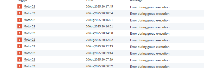

Hi,
When I want to test the Realtime Group followed the tutorial –Realtime Group, I found this error. Motor02 is Errored. （I cannot find more info from the gateway log. it only shows info below.
 ![image](https://us1.discourse-cdn.com/inductiveautomation/original/3X/b/8/b895a24e3f02cebebf4db187c684ac33f95edebc.png)
I confirm the problem is caused by update/select “key/value pairs”
Because if I select insert new row, … They all worked.
Can you explain why. I did what the tutorial told me to do.
Is it a bug or I did something wrong. (I am using 8.1.48)
Thanks.
 ![1](https://us1.discourse-cdn.com/inductiveautomation/original/3X/e/6/e68ff0186a5628e2ecfeff8c66ee50ca2fe905f2.png)
 ![2](https://us1.discourse-cdn.com/inductiveautomation/original/3X/6/7/67cd2f78de135f7766897cada50aac3b2a106cff.png)

I've never used the key/value pairs option. Have you tried using the "custom" option?

~~You are telling the Transaction group to update the row of data based on the fact that the column motors\_1\_ndx is a value of 2. If there is no value of 2 in that column for the data to update, what do you expect the group will do?~~
I should really have another cup of coffee. Sigh.
I'm with @jordanCclark. I have better luck with custom.
**Post date:** [August 21, 2025, 12:40pm UTC](https://forum.inductiveautomation.com/t/transaction-group-realtime-group/109980/4 "2025-08-21T12:40:01Z")
He has _Insert row when not present_ checked.
I usually have better luck getting it to work using custom vs key/value

I did try the Custom, it works. I am just curious why it doesn’t work based on the tutorial. 😀
