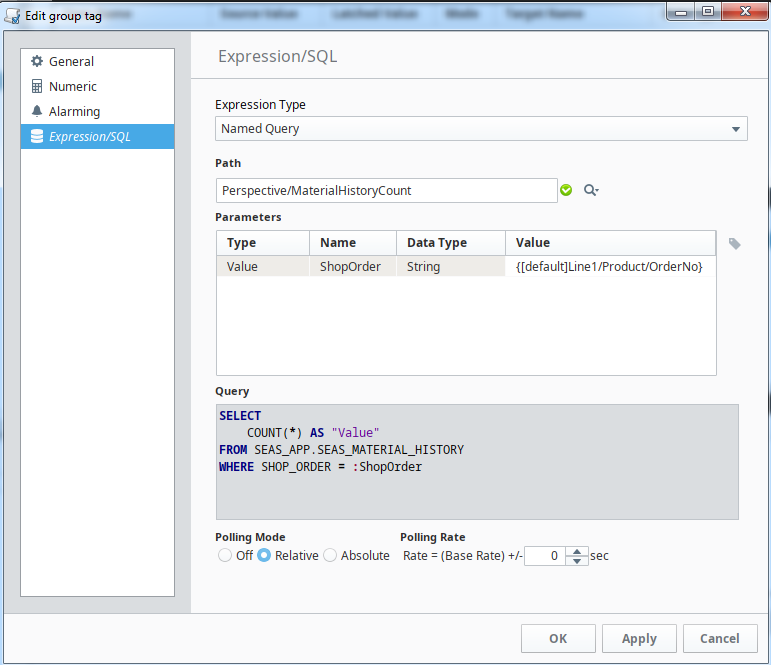

The Run Always Expression Item is set up like so:
 ![item_gen](https://us1.discourse-cdn.com/inductiveautomation/original/3X/6/d/6d16931aa5d62cf4e3043db02f51d5f6a295a5d2.png)
 ![itemSQL](https://us1.discourse-cdn.com/inductiveautomation/original/3X/8/0/8077cbdae9eb31379af7bfb5b3e928cbd4d1def8.png)
I have verified that the value passed into the named query is actually a shop order value by showing the tag in my perspective client.
I adjusted the trigger settings as suggested but am still getting this issue.
Cheers,
Iain
**Author:** ![iain.blackwood](https://avatars.discourse-cdn.com/v4/letter/i/ea5d25/32.png) [@iain.blackwood](https://forum.inductiveautomation.com/u/iain.blackwood)\
**Post date:** [July 2, 2021, 10:04am UTC](https://forum.inductiveautomation.com/t/transaction-groups-expression-item-a-tag-executor-could-not-be-created-for-the-item/47777/5 "2021-07-02T10:04:53Z")
Hi Guys,
In the end I could not get this to work as I wanted.
I made a work around by creating a Memory Tag from Query (Query Tag).
I can then just add this tag to my transaction group in the normal manner.
Actually this way seems much cleaner that what I was trying to do in the first place.
