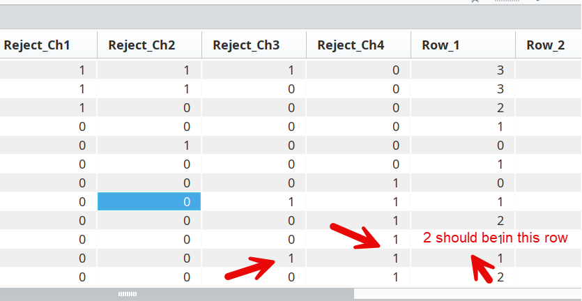

I have a problem with Latch Value. It insert to database previous value not current value.
Any idea how to fix this issue?

That commonly happens when a non-trigger item is a tag. OPC doesn't have ordered delivery, so a trigger could fire before the rest of the tags are "fresh".
The answer is to replace the items that point at OPC tags with items that point directly at the OPC value, and set the transaction group to OPC "Read" mode. That causes a fresh read to happen just after the trigger, pulling in values that are certain to be "after" the trigger.

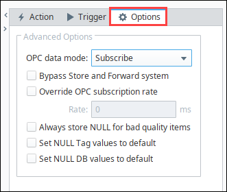

Thanks for quick relay. I am new Ignition. Where can I set the OPC to "Read" Mode.
I can't find "Read" in the Mode as shown below
Please! Advice

Advanced settings, upper right window if using default designer layout.

Change OPC mode from `subscribe` to `read`
**Post date:** [July 21, 2025, 3:26pm UTC](https://forum.inductiveautomation.com/t/transaction-groups-source-value-vs-latched-value/30673/9 "2025-07-21T15:26:19Z")
Remember that the change in OPC data mode does not apply to **tags**. You must replace those members in your transaction with OPC Items, typically dragged from the OPC Browser (not the Tag Browser).
