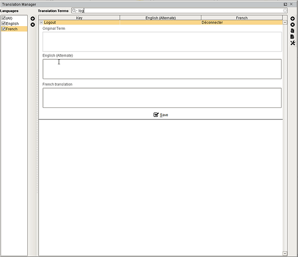

As a side note :
I’ve a weird behaviour when I edit term in the translation manager (7.9.5)
If I use a **translations terms filter** the Save action has no effect.
If I edit without the translation term filter it’s ok, but when I came back with the filter the translation term inputed is empty ☹

**Author:** ![KathyApplebaum](https://sea1.discourse-cdn.com/inductiveautomation/user_avatar/forum.inductiveautomation.com/kathyapplebaum/32/7261_2.png) [@KathyApplebaum](https://forum.inductiveautomation.com/u/KathyApplebaum)\
**Post date:** [November 28, 2017, 3:58pm UTC](https://forum.inductiveautomation.com/t/translate-inactivity-popup/16146/4 "2017-11-28T15:58:35Z")
Yikes! I’ll make a ticket to get that fixed. Thanks for letting us know.

**Post date:** [November 29, 2017, 6:13pm UTC](https://forum.inductiveautomation.com/t/translate-inactivity-popup/16146/7 "2017-11-29T18:13:28Z")
@mazeyrat
The issue with searching a translation term is actually related to another issue with the translation manager - in certain circumstances (ie, after sorting) it would edit the wrong row, which is what I found when I tried to reproduce the editing issue. The fix for that is going to be in 7.9.7, and I can confirm that it fixes the issue you ran into.
