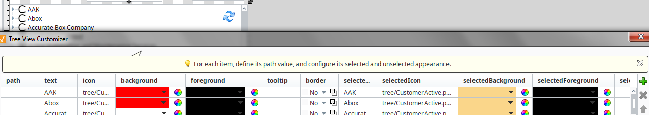

I have a tree component where the highest level items have a conditional background color based on a column. Here is the relevant part of the query -

and here in the designer, when I look at tree customizer, the condition does seem to come through correctly -
 ![image](https://us1.discourse-cdn.com/inductiveautomation/original/3X/a/9/a9b691f6ff45f5ddacb74ec7a6a5553f779876a3.png)
But as you can see in the tree itself, the background of AAK and Abox are not red, despite the tree customizer says it should be. What am I missing here? How can i fix this?
**Author:** ![bkarabinchak.psi](https://sea1.discourse-cdn.com/inductiveautomation/user_avatar/forum.inductiveautomation.com/bkarabinchak.psi/32/83567_2.png) [@bkarabinchak.psi](https://forum.inductiveautomation.com/u/bkarabinchak.psi)\
**Post date:** [October 9, 2020, 5:21pm UTC](https://forum.inductiveautomation.com/t/tree-background-color-not-displaying/39541/2 "2020-10-09T17:21:49Z")
Oddly enough if I do
`IF(`listcustomers`.`creditHold`=True,'color(255,80,80,255)','color(255,255,255,255)') AS `foreground`,`
in my query, that DOES affect the foreground color.
**Author:** ![dtrottier](https://avatars.discourse-cdn.com/v4/letter/d/b5a626/32.png) [@dtrottier](https://forum.inductiveautomation.com/u/dtrottier)\
**Post date:** [February 12, 2021, 12:51pm UTC](https://forum.inductiveautomation.com/t/tree-background-color-not-displaying/39541/3 "2021-02-12T12:51:57Z")
Same problem here, foreground color is working, background color changes will not affect the color
