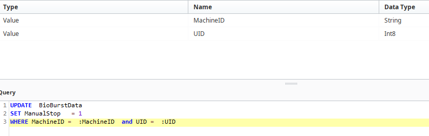

I am trying to run an update query on a button press that would switch a value in the table based on 2 parameters. Here is my query:
 ![image](https://us1.discourse-cdn.com/inductiveautomation/original/3X/e/5/e5922de5e927fab0983b5cafbada0796d9a1e5d5.png)
and here is the script I am running on button press:

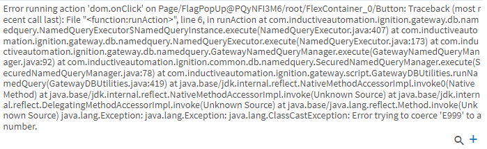

But when I press the button I get this error in my logs on the gateway:
 ![image](https://us1.discourse-cdn.com/inductiveautomation/original/3X/1/5/15a1412d6fd572404a89358be5803e7b9ac0402d.png)
Any ideas on what I am doing wrong?

The bottom of the error log says that you're trying to coerce 'E999' to a number.
I suspect that you have fed 'E999' into the UID parameter which is expecting an Int8 datatype.
**Author:** ![Ryan\_Craig](https://avatars.discourse-cdn.com/v4/letter/r/45deac/32.png) [@Ryan\_Craig](https://forum.inductiveautomation.com/u/Ryan_Craig)\
**Post date:** [March 15, 2024, 3:29pm UTC](https://forum.inductiveautomation.com/t/trouble-passing-params-to-query-through-script/87405/3 "2024-03-15T15:29:35Z")
That was an obvious overlook by me, Thank you!
