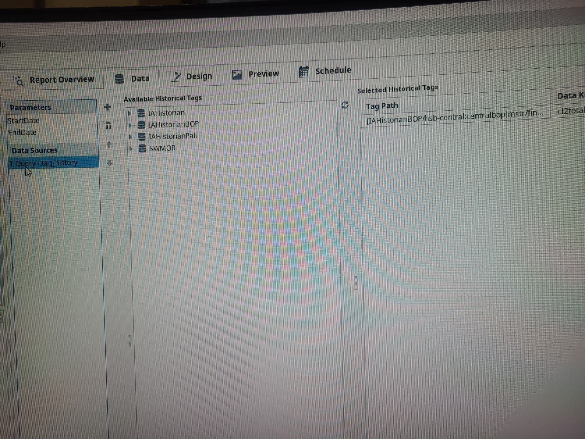

Im completely new to ignition and my boss wanted me to setup a tag historian with 15 minute timestamp. I took pics of what i have. Just not sure how to make the time it take data every 15 minutes only.

Your screenshots show the reporting module’s designer. That is used to display data that you’ve collected. It isn’t the historian. To record values on a strict schedule, I recommend using the SQL Bridge module’s transaction group, which can be scheduled to run every 15 minutes. That will put your selected tags’ data into a conventional database table with timestamp column. The report would then query that table for the desired time range.
