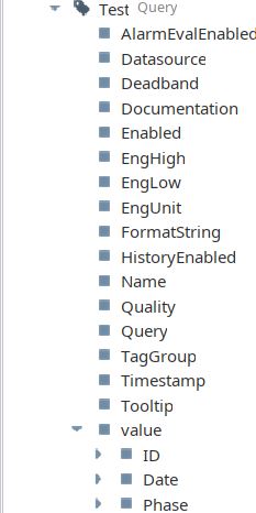

Hello,
I was wondering if there was a way to turn the dataset values returned from a query tag into individual tags.
For example as per the picture shown “ID”, “Phase”, and “Date” would all be individual tags.
Thank you!
![Datasetquestion](https://us1.discourse-cdn.com/inductiveautomation/original/2X/d/d5d9b08a7b41341ce6358ef9dd25ce1e8a961da0.jpeg)
**Post date:** [January 29, 2020, 6:45pm UTC](https://forum.inductiveautomation.com/t/turning-query-tag-values-into-individual-tags/31727/2 "2020-01-29T18:45:15Z")
Look at the Dataset Access portion of this page:
[https://docs.inductiveautomation.com/display/DOC80/Expression+Overview+and+Syntax](https://docs.inductiveautomation.com/display/DOC80/Expression+Overview+and+Syntax)
