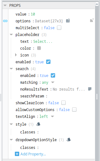

**Author:** ![hw79](https://avatars.discourse-cdn.com/v4/letter/h/838e76/32.png) [@hw79](https://forum.inductiveautomation.com/u/hw79)\
**Post date:** [December 5, 2022, 7:23pm UTC](https://forum.inductiveautomation.com/t/two-dropdowns-give-no-results-on-the-table/67232/7 "2022-12-05T19:23:05Z")
Dropdown\_0:
 ![image](https://us1.discourse-cdn.com/inductiveautomation/original/3X/a/7/a7952fb3588c0ebb5615584501920167e779f5e4.png)
I just noticed the value should be the concatenated value that's selected, it's only showing the last two digits. It should be in the format of XXX-YY and it's only showing YY
**Post date:** [December 5, 2022, 8:30pm UTC](https://forum.inductiveautomation.com/t/two-dropdowns-give-no-results-on-the-table/67232/8 "2022-12-05T20:30:08Z")
> [@hw79](#):
I would say that is your issue then. Let us know if you're still having issues after correcting the value of this drop down.

**Post date:** [December 5, 2022, 8:56pm UTC](https://forum.inductiveautomation.com/t/two-dropdowns-give-no-results-on-the-table/67232/10 "2022-12-05T20:56:07Z")
Well, you will probably need to do a transform on the Options Dataset.
Can you show what the options dataset looks like? And what two values are intended to be concatenated together to yield the actual value you are looking for?
