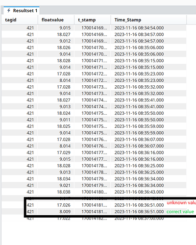

I have setup a expression tag history as in picture, however, when I query the results I am getting two timestamps and two values for the same tag.
 ![History Setup](https://us1.discourse-cdn.com/inductiveautomation/original/3X/8/9/89a259d6230864843b449f621ca5468a9f8a7040.png)
So every time there is a value change there is a higher value number first and then the "correct" number that I see in the tag browser.
 ![dual results](https://us1.discourse-cdn.com/inductiveautomation/original/3X/8/b/8b1bc3371c4a57254df0de479219bc395c3c38b1.png)
Any thoughts why I see these two time stamps and one higher value? I thought I have interpolation off with the setup, but maybe I do not?

Have you got some code changing `Cycle Time Start` and `Cycle Time Stop` simultaneously? If so then your expression might be firing twice - once for each tag change.

On the Cycle Time Start I have this script:
if currentValue.value !=previousValue:
	value = previousValue
	system.tag.writeBlocking("[default]Line F Traub/Cycle Times/Cycle Time Stop", [value])
So it does look like it is reading the current and previous value.
Any thoughts on how to only read one value? Write the "previous cycle time" value to another memory tag?
**Post date:** [November 21, 2023, 12:56pm UTC](https://forum.inductiveautomation.com/t/two-timestamps-for-one-value/81984/7 "2023-11-21T12:56:57Z")
> [@Jim\_Perks](#):
> `if currentValue.value !=previousValue:`
This is always true, unless you made a typo.
`currentValue.value` is a true value (int,string, float, etc....) while `previousValue` is a QualifiedValue object, they are never equivalent.
You should also filter for initial change
It should be:
```python
if not initialChange and currentValue.value != previousValue.value:
Not filtering for initialChange means that anytime the tag resets you will also run this tag write. So save edits to the tag, restart the gateway, etc...
**Author:** ![Jim\_Perks](https://avatars.discourse-cdn.com/v4/letter/j/ec9cab/32.png) [@Jim\_Perks](https://forum.inductiveautomation.com/u/Jim_Perks)\
**Post date:** [November 21, 2023, 5:43pm UTC](https://forum.inductiveautomation.com/t/two-timestamps-for-one-value/81984/8 "2023-11-21T17:43:43Z")
Yes, thank you for catching that oversight. I did add the not initialChange, however, it still is adding the previous value to the current value.
	value = previousValue.value
	system.tag.writeBlocking("[default]Line F Traub/Shift Data/First Shift /Cycle Times/Cycle Time Stop", [value])
 ![tagid421c](https://us1.discourse-cdn.com/inductiveautomation/original/3X/9/5/95bb724447bb0d90c096d12b7b985717e04aeff9.png)
The 9.017 adds to the 6.013 and then I get that 15.03.
So the way I wrote the cycle time recording does not work well with storing the value for averaging 🙂
Here is how I calculate it. It works, but not for reading from the SQL DB because I read the two values.

**Post date:** [November 21, 2023, 6:33pm UTC](https://forum.inductiveautomation.com/t/two-timestamps-for-one-value/81984/10 "2023-11-21T18:33:27Z")
Make it a memory tag instead of expression tag. Use the script to write everything at once.
```python
	cycleTime = system.date.millisBetween(previousValue.value, currentValue.value)/1000.0
	tagsOut = ["[default]Line F Traub/Cycle Times/Cycle Time Stop",
	           "[default]Line F Traub/Cycle Times/Previous Cycle Time"
	system.tag.writeBlocking(tagsOut, [previousValue.value, cycleTime])
**Post date:** [November 21, 2023, 8:32pm UTC](https://forum.inductiveautomation.com/t/two-timestamps-for-one-value/81984/12 "2023-11-21T20:32:38Z")
That worked! 🙂
Learned about the tagsout aspect as well. I did not know you could do that.
Thanks again!
