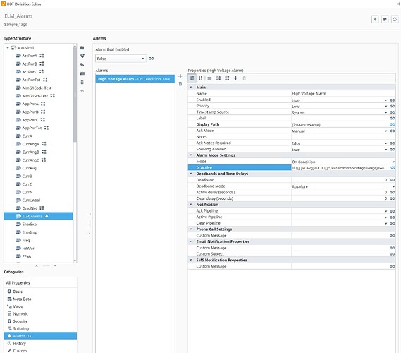

I have a bunch of UDT's set up for different device manufacturers. I would like to set up a umbrella Expression Tag to house all my alarms for each manufacturer UDT (would be better if I could do this above all UDT's if possible instead of for each manufacturer). For example, I am trying to set a High Voltage Alarm for several electrical meters. The problem is, I have multiple voltage ranges from 208V, 480V and 13.2kV, so I can't just say IF (Voltage Line \> 480, true, false). This would enable alarms for the 208V meters and any meters that go above 480V. I thought I could add a UDT parameter "voltageRange" that I could use in an IF statement to check the above three voltages, then a second IF statement to set my condition above a high voltage setpoint to enable the alarm. But I cannot seem to get my expression code correct. Does anyone have any ideas how to get this to work? Please see images and description/code for how I have my Expression tag set up.
1. UDT with "ELM\_Alarm" Expression tag with "Value" set to **{[~]}** (This was to view any tag inside the UDT)
2. High Voltage Alarm with "Alarm Mode Settings" set to "On Condition Mode" with "Is Active" set to **IF ({[.]VLAvg}\>0, IF ({[~]Parameters.voltageRange}=480, true, false))** (Please note I am trying to get my 480V meters to enable above VLAvg\>0 just to test out the code)
3. I am successful using **IF ({[.]VLAvg}\>0, true, false)** on the individual UDT tag VLAvg, this enables alarms, but for all voltages mentioned above. So I feel my code referencing the voltageRange parameter is incorrect, or using the ELM\_Alarm expression tag.
 ![UDTAlarms(1)](https://us1.discourse-cdn.com/inductiveautomation/original/3X/4/c/4c544144a8b0f6a3a90c833c54b2292cc768d995.jpeg)
 ![UDTAlarms(2)](https://us1.discourse-cdn.com/inductiveautomation/original/3X/a/2/a24a6fec3a020c0fa9b43ae6f9f33db8ef2d581d.jpeg)

OK, so looking at this again, setting my "Value" of the Expression Tag **ELM\_Alarms** to **`{[~]}`** as a string works with using **`IF ({[.]VLAvg}>0, true, false)`** this gets successful alarms enabled. But why doesn't using **`IF ({[.]Parameters.voltageRange}=480, true, false)`** work the same? I set a UDT parameter of voltageRange = 480 for a single meter.
Nor does this work,
**`IF ({[.]/Parameters.voltageRange}=480, true, false)`**
**`IF ({voltageRange}=480, true, false)`**
**Author:** ![Tyler\_Dixon](https://avatars.discourse-cdn.com/v4/letter/t/e56c9b/32.png) [@Tyler\_Dixon](https://forum.inductiveautomation.com/u/Tyler_Dixon)\
**Post date:** [May 27, 2026, 4:45pm UTC](https://forum.inductiveautomation.com/t/udt-expression-tag-with-alarm-if-statement-to-compare-tag-parameters-and-tag/115734/3 "2026-05-27T16:45:31Z")
Ahhh-haaaaa! Got it to work!! See I just needed some of you to view my mubbling to get it to work, LOL!!!
SOLUTION
**`IF ({voltageRange}="480" && {[.]VLAvg}>0, true, false)`**
BUT..............
Can this be done above all UDT's? Please see image. Can it scan all UDT's below and enable alarms?
This doesn't seem to work when setting the Expression tag value:
 ![UDTAlarms(3)](https://us1.discourse-cdn.com/inductiveautomation/original/3X/c/7/c77bc6c55cdd3a6ffe916d88eba956d0adffb912.jpeg)
**Post date:** [May 27, 2026, 4:48pm UTC](https://forum.inductiveautomation.com/t/udt-expression-tag-with-alarm-if-statement-to-compare-tag-parameters-and-tag/115734/4 "2026-05-27T16:48:59Z")

You are correct. It seems that I am only able to do this nested inside a UDT definition, using the following:
Setting my "Value" of the nested Expression Tag called **ELM\_Alarms** to **`{[~]}`** as a string, using **`IF ({[.]VLAvg}>0, true, false)`** alarm testing for high voltage above zero. This looks at/monitors all my meters that use the same defintion and returns alarms.
I have around 12-15 UDT definitions (likely more for future integration) adds time and management to the project. My question revolves around decreasing time and management in hopes to have the Expression Tag called **ELM\_Alarms** nested **outside** of all my UDT definitions. That way I program once, add or remove once, not having to go through each UDT definition. I believe @pturmel answered the question, using **`{[~]}`** outside of all UDT definitions won't work since they are in seperate folders. I'll be honest, I don't understand how this works in the background, it working nested inside vs nested outside the UDT definitions. Either case, I at lease am able to minimize some alarming programming using the "nested inside" method which is HUGE!

You tagged this as v8.3. Are you not able to use the built-in alarm status tags?
FWIW, I would **not** try to pull all of your alarmable values into a single expression, as that expression with evaluate for **every** tag change it references.
Individual alarms attached to their atomic source tags are the most efficient. Build this into your UDTs.

I'm also having trouble tracking why you are going about it this method. Each UDT should have it's own alarm configuration and you set the setpoints and enables via Parameters on the UDT. You can even bulk write to those Parameters if you want to save config time. Within each UDT name the alarms appropriately. The UDT generates the alarm.
And then for your alarm monitor if you only want to extract the High Voltage Alarm's then you would use an expression like below and adjust it accordingly for the relative folder path and/or minimum severity.
```python
isAlarmActiveFiltered("[.]../*", "High Voltage Alarm", "*", 0, 4, 0, 1, 0)
Edit: Oh I see you want only a subset of alarms based on their specific voltage. If that's the case I'd probably just be lazy and create a HV alarm for each level and then only enable the relative one via Parameters and then in the filter use HV alarm 208V or whatnot.

No, you set up the alarms in the UDTs. So you only touch the definitions and the instance parameters.
Your deployment sounds very much like a typical Solar plant, where UDTs are the solution to the kind of complexity you describe. Build the alarms into the UDT definitions.

This is what scripting is for so you can edit the tag json in bulk, either direct in script or via edits made in excel.
As everyone is saying, you should be using tags within the UDT definitions for your alarms. You are using a bizarre quirk which another integrator looking at the project would raise their eyebrows at.
Also, for all of those UDT instances and tags you mentioned, you are subscribing to all of them via those expression tag refs to the UDT root level. This will be impacting your gateway and affecting the scalability
