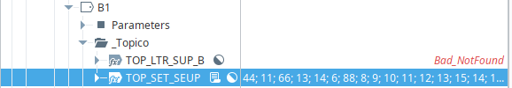

I have some tag change scripts in normal memory tags. They work perfectly.
I had a UDT instance with a tag change in one of the tags within the UDT that doesn't work quite right.
I take a large string from my mqtt and separate the position I need and put it in my UDT tag. I force the write from scratch and finally get the value I want. And it WORKS, but when I shut down the computer and open everything again, it doesn't work. I have to go directly to the tag (here outside the UDT definition tab), write anything, and it updates and the script works as it should.
Translated with [DeepL.com](http://DeepL.com) (free version)
 ![image](https://us1.discourse-cdn.com/inductiveautomation/original/3X/4/b/4b4858413b050363cde00363e72155d80c1451ec.png)
But I can't understand why it only doesn't work in the UDT instance.
Does anyone have any idea what I can do? I apologize if it's too obvious, I'm new to Ignition and Python.
I want to do it through UDT, because I will have several pumps and other instruments in the project and it would take too long to develop scripts with each tag path to change via gateway event script pump by pump.

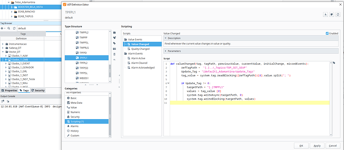

**Author:** ![gustavo.chamorro](https://avatars.discourse-cdn.com/v4/letter/g/eb8c5e/32.png) [@gustavo.chamorro](https://forum.inductiveautomation.com/u/gustavo.chamorro)\
**Post date:** [August 4, 2025, 5:53pm UTC](https://forum.inductiveautomation.com/t/udt-instance-value-changed-not-working/109327/3 "2025-08-04T17:53:25Z")
> [@ryan.white](#):
> Assuming you are using the same UDT for each pump (or similar UDTs for groups of pumps),
> Gateway tag event scripts allow wildcards at the folder level when defining the tags to monitor.
Sorry, here's the script
This one is in the UDT instance.
```python
def valueChanged(tag, tagPath, previousValue, currentValue, initialChange, missedEvents):
		refTagPath = "[.]../_Topico/TOP_SET_SEUP"
		Update_Tag = "[.]../_Updt_Dados_Cmb/Update_Tags"
		tag_value = system.tag.readBlocking([refTagPath])[0].value.split("; ")
		if Update_Tag != 0:
			targetPath = "[.]TMPPL1"
	    	values = tag_value[0]
	    	system.tag.writeAsync(targetPath, 0)
	    	system.tag.writeBlocking(targetPath, values)
My refTagPath It's the big string, it leaves the PLC, goes to a broker, and arrives via MQTT in Ignition. At the moment, it only has random numbers, as you can see.
When I change the refTagPath, TMPPL1 (the UDT tag I'm testing in isolation) changes the value.

**Post date:** [August 4, 2025, 6:04pm UTC](https://forum.inductiveautomation.com/t/udt-instance-value-changed-not-working/109327/4 "2025-08-04T18:04:33Z")
This:
```python
if Update_Tag != 0:
Is always true, and I don't think that is your intended purpose. I'm not sure as you clearly know that you need to read the tag to get its value as demonstrated in the assignment of tag\_value.
Also, using `system.tag.writeAsync()` imediately prior to a `system.tag.writeBlocking()` call to the same path, makes no sense. There isn't even really a gaurentee that the writes happen in that order. Just use the blocking write.
Instead you should do something like:
```python
tagPaths = ['[.]../_Topico/TOP_SET_SETUP','[.]../_Udpt_Dados_Cmb/Update_Tags']
refTag,updateTag = [qv.value for qv in system.tag.readBlocking(tagPaths)]
if not updateTag:
    system.tag.writeBlocking(['[.]TMPPL1'],[refTag.split('; ')[0]])
