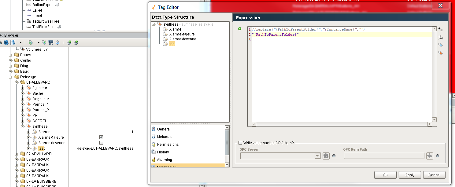

Inside UDT {PathToParentFolder} don’t contain the tag provider (Ignition 7.9.5)
To use it in a tag expression, (as in the gateway scope the tag provider is mandatory), it would be convenient to have the provider in this paramaeter or in a PathToParentFolderWithProvider if this change could cause som compatibility issue when upgrading ignition to 7.9.X
Example :
 ![](https://us1.discourse-cdn.com/inductiveautomation/original/2X/f/f4901aa112aa5d6a18f72b22c760b04e2fa80230.png)
