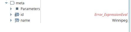

I’ve got the following UDT:
 ![image](https://us1.discourse-cdn.com/inductiveautomation/original/3X/d/9/d9ba4db8e0791c2e1c2b88b560f7bcb47a097cc3.png)
I get the following error in my instance: `Error_ExpressionEval("Unknown column 'Winnipeg' in 'where clause'")`
 ![image](https://us1.discourse-cdn.com/inductiveautomation/original/3X/7/2/72eb410aa63800620a79653130af42ef8865b00d.png)
But if I use
```sql
SELECT id FROM sites WHERE name = "Winnipeg"
I get the right value.
**Author:** ![Leor\_Fishman](https://avatars.discourse-cdn.com/v4/letter/l/e19adc/32.png) [@Leor\_Fishman](https://forum.inductiveautomation.com/u/Leor_Fishman)\
**Post date:** [October 31, 2025, 2:22pm UTC](https://forum.inductiveautomation.com/t/udt-query-tag-not-behaving-as-expected/111861/2 "2025-10-31T14:22:00Z")
Wrap the tag in quotes?
**Post date:** [October 31, 2025, 2:29pm UTC](https://forum.inductiveautomation.com/t/udt-query-tag-not-behaving-as-expected/111861/3 "2025-10-31T14:29:38Z")
In single quotes.... Double quotes for string constants are only supported for MariaDB and friends, and only when **not** in standards-compliant mode.
**Author:** ![Torsten\_Giesbrecht1](https://avatars.discourse-cdn.com/v4/letter/t/f17d59/32.png) [@Torsten\_Giesbrecht1](https://forum.inductiveautomation.com/u/Torsten_Giesbrecht1)\
**Post date:** [October 31, 2025, 2:42pm UTC](https://forum.inductiveautomation.com/t/udt-query-tag-not-behaving-as-expected/111861/4 "2025-10-31T14:42:15Z")
That did the trick thank you!
