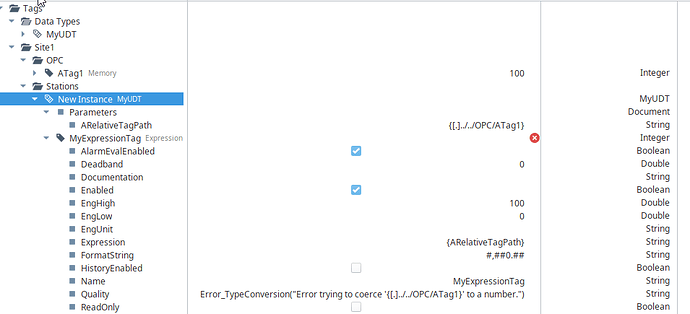

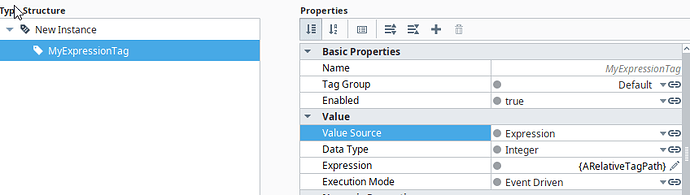

I have several clients who pass in relative tag paths into UDTs as string parameters ( {[.]…/…/OPC/ATag1} ). Inside the UDT, there will be an expression tag with {ARelativeTagPath} as the expression. This has been working fine in 7.9, but no longer works in 8.0
Is this no longer supported?
 ![image](https://us1.discourse-cdn.com/inductiveautomation/original/3X/4/d/4dd1731865be80b17b18b1c4b86d66f5ea4188f9.png)

Late response, but better late than never I suppose. In your case, you actually have to modify the UDT parameter and expression tag like so:
1. Modify the expression in the expression tag like so:
`tag({ARelativeTagPath})`
2. Remove the brackets from the UDT parameter so it looks like this:
`[.]…/…/OPC/ATag1`
After following these steps, I was able to resolve a similar UDT expression tag path in my local system.
