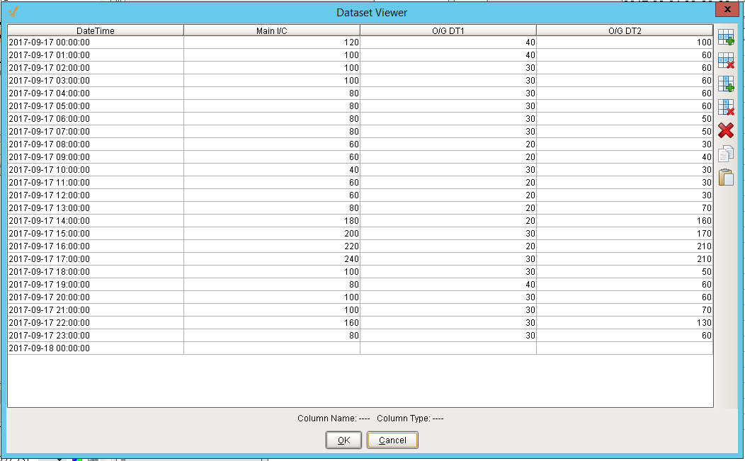

![](https://us1.discourse-cdn.com/inductiveautomation/original/2X/a/a7e4e49a9824110fbd188af3456866b9503ee2ea.png)
The dataset looks something like this. This contains hourly consumption of KWh values wherein 00:00:00 shows consumption for the hour from 00:00 to 01:00, in 01:00:00 for 01:00 to 02:00 and so on.
The dataset is dependent on date selection via popup calendar where binding has been created to extract 24-hour data for the selected date.
Bar Chart is unable to pick this dataset & shows blank chart.
