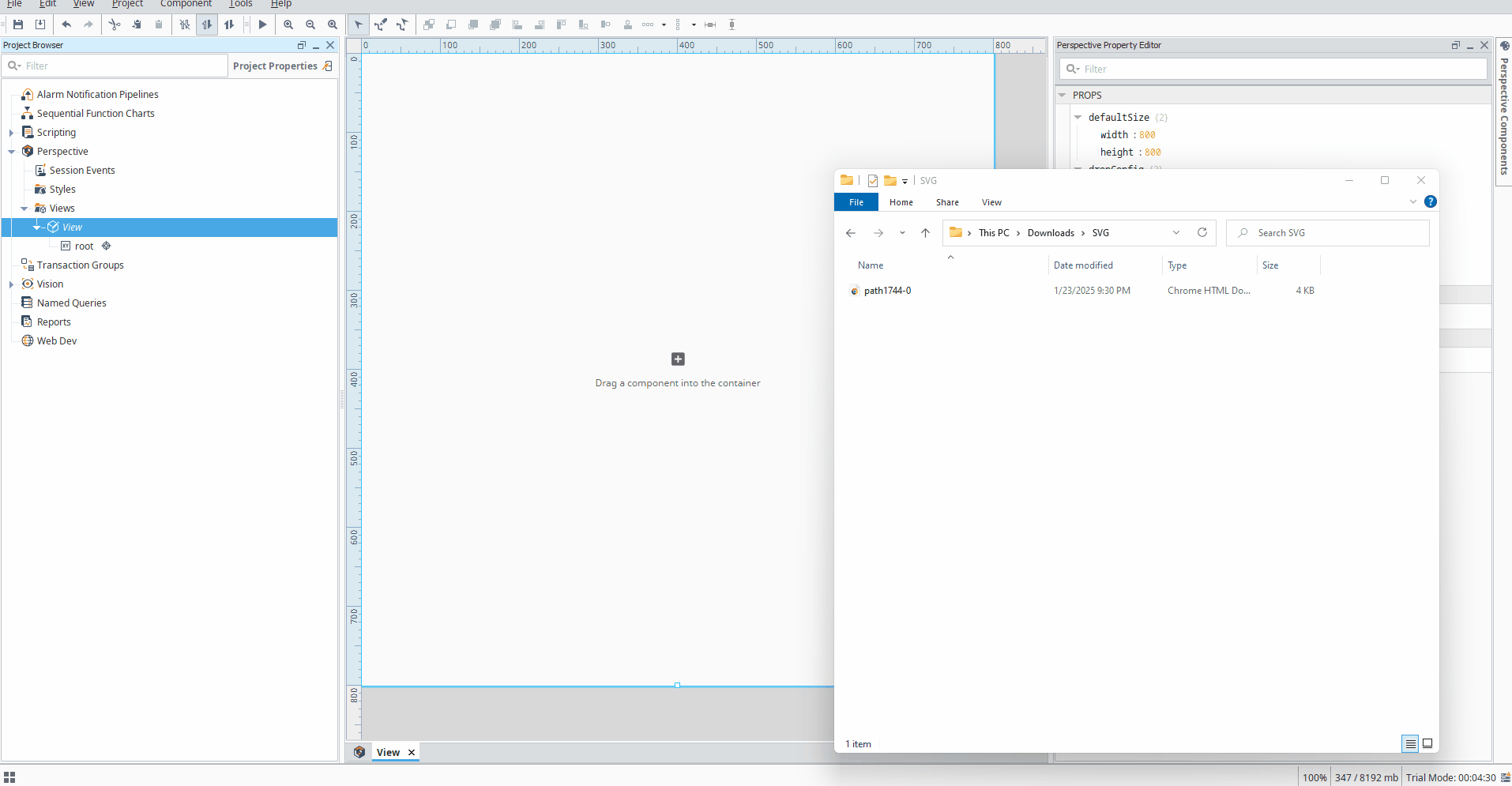

I'm currently studying and experimenting in ignition sdk modules. And i noticed that when a perspective-component-minimal module is installed in the gateway, the drag and drop svg action into the designer is not working anymore.
This is the behaviour when the module is installed.
![image](https://us1.discourse-cdn.com/inductiveautomation/original/3X/f/0/f0fa6df278bbc2bd65afc59f9ee563f76ef908a0.png)
 ![draganddropsvg](https://us1.discourse-cdn.com/inductiveautomation/original/3X/6/3/631020426ff371ae39dcd528c4243e13085edd10.gif)
And when i uninstalled/removed the perspective-component-minimal module
 ![draganddropsvg2](https://us1.discourse-cdn.com/inductiveautomation/original/3X/b/5/b530eb055a8a4cc58ba922cf60611807569ad186.gif)

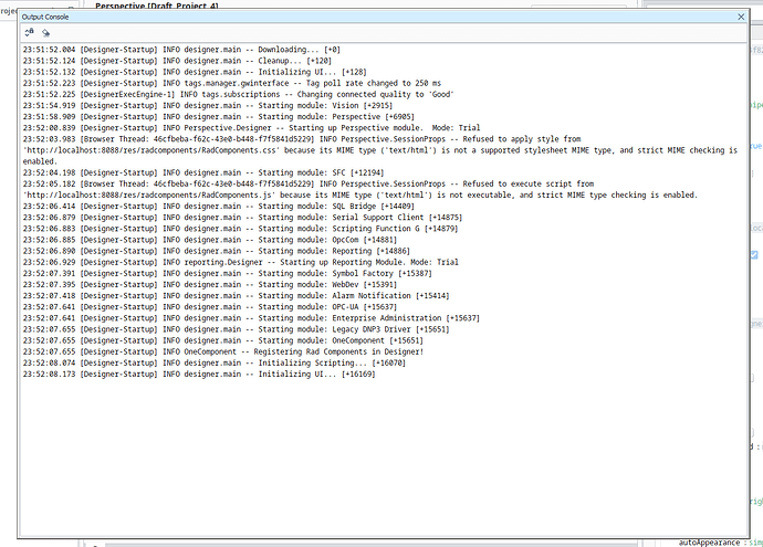

Are there any errors in the _designer_ console with your module loaded?
**Author:** ![PersistentLearner255](https://avatars.discourse-cdn.com/v4/letter/p/ce73a5/32.png) [@PersistentLearner255](https://forum.inductiveautomation.com/u/PersistentLearner255)\
**Post date:** [August 18, 2025, 3:49pm UTC](https://forum.inductiveautomation.com/t/unable-to-drag-and-drop-svg-elements-into-designer-after-installing-modl/109889/3 "2025-08-18T15:49:39Z")
The module seems fine
 ![image](https://us1.discourse-cdn.com/inductiveautomation/original/3X/2/5/25abf56d8d60b735c5f9c22077a541bb7f38d4e4.png)

![image](https://us1.discourse-cdn.com/inductiveautomation/optimized/3X/3/a/3a3e874ed1cddc189572a64de4db8dca7b5b92b6_2_690x27.png)
Hmm.
I think the class loading error in the example is causing the fetch of the component Javascript to fail (return a 404 page) which may be causing knock-on effects that end up with drag and drop not working. At least, that's my best guess at the moment.
If you go into the `OneComponentGatewayHook` and remove this method implementation:
```python
    @Override
    public void onMountedResourceRequest(String resourcePath, HttpServletResponse response) {
        super.onMountedResourceRequest(resourcePath, response);
Then optimize imports and rebuild the module, it should work. The underlying problem is the Jetty upgrade we did in 8.1.49:
> [@Ignition 8.1 Jetty 12 Upgrade](https://forum.inductiveautomation.com/t/ignition-8-1-jetty-12-upgrade/105482):
