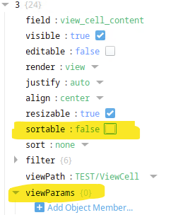

**Author:** ![Raphael](https://avatars.discourse-cdn.com/v4/letter/r/edb3f5/32.png) [@Raphael](https://forum.inductiveautomation.com/u/Raphael)\
**Post date:** [February 4, 2026, 4:46pm UTC](https://forum.inductiveautomation.com/t/unable-to-pass-value-in-table-viewcell/113753/13 "2026-02-04T16:46:24Z")
The sort icon is not showing because I unchecked the sortable option.
 ![image](https://us1.discourse-cdn.com/inductiveautomation/original/3X/d/3/d3933962be400f4ecaf8674cf4cede1a67d42eba.png)
Also, I didn’t create the parameters in the viewParams object, but I think they’re mandatory in the view cell.
I tried deleting them and, as expected, the binding had a null reference.
 ![image](https://us1.discourse-cdn.com/inductiveautomation/original/3X/e/9/e95aebb31d073492ab430f14a9b0e0486b1bb880.png)
