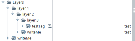

Hello,
I have a script that was failing to read a tag that was in a folder 2 levels up from the triggering tag (change event). I confirmed in documentation that I should be able to do this by using '..' twice:
> Additionally, you can use " **..**" (two periods) to go back one folder from the current relative position, for example [.]../../tag allows you to reference a Tag that is two folders up.
I made a few test tags: There are 3 layers of folders. The bottom layer has a tag with a change event that attempts to write to a tag in one of the parent folders. When pointed up one level with the path '[.]../writeMe', it writes with no issue. When pointed up to the top level with '[.]../../writeMe', it fails to write.
Is there something that might be causing this to fail that I am missing? Is there a different syntax that can be used here, aside from using the full tag paths?
Thanks,
Andrew

**Post date:** [January 19, 2023, 6:21pm UTC](https://forum.inductiveautomation.com/t/unable-to-read-write-to-tags-2-directories-up-using-tag/68798/2 "2023-01-19T18:21:27Z")
I haven't built this folder structure out and tested this, but I'm pretty sure that you're second example is one level further than the path you were using.
`[.]../writeMe` is at the same level as the `Layer 3` folder. `[.]../../writeMe` would be to a tag which was in the `Layer 1` folder, however, looking at your screen shot, the second `writeMe` tag is actually in the `Layers` folder. I believe the correct path would be `[.]../../../writeMe`.
**Author:** ![Andrew\_Hyles](https://sea1.discourse-cdn.com/inductiveautomation/user_avatar/forum.inductiveautomation.com/andrew_hyles/32/30004_2.png) [@Andrew\_Hyles](https://forum.inductiveautomation.com/u/Andrew_Hyles)\
**Post date:** [January 19, 2023, 11:40pm UTC](https://forum.inductiveautomation.com/t/unable-to-read-write-to-tags-2-directories-up-using-tag/68798/3 "2023-01-19T23:40:00Z")
Irose,
Good catch! thank you!
Unfortunately, I'm still unable to reach this tag after correcting the location. Please see below corrected structure and the script attempting the write:
 ![image](https://us1.discourse-cdn.com/inductiveautomation/original/3X/9/c/9c47b1d1a704a970b6e9f9254f0a02681ac4cc3e.png)
Thanks again,
Andrew

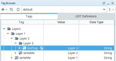

**Post date:** [January 20, 2023, 12:55pm UTC](https://forum.inductiveautomation.com/t/unable-to-read-write-to-tags-2-directories-up-using-tag/68798/4 "2023-01-20T12:55:23Z")
I'm not sure. I set up this structure on a dev gateway and it worked as expected.
 ![image](https://us1.discourse-cdn.com/inductiveautomation/original/3X/3/d/3dcbad0b9571e17c4f5b320b030b1a663a4ad744.png)
 ![image](https://us1.discourse-cdn.com/inductiveautomation/original/3X/0/9/09c905497b337f06765b6244a700dc775524ec5f.png)
I will note, however, that the best way to write this script would be to combine the writes into one.
```auto
def valueChanged(tag, tagPath, previousValue, currentValue, initialChange, missedEvents):
	system.tag.writeBlocking(['[.]../writeMe','[.]../../writeMe'],['Layer 2','Layer 1'])
This server was using V8.1.20, so may not be a one to one with what you have.
If you open the diagnostics view on the Tag Editor, is there any error reported?
Might be worth having support poke around.
**Post date:** [January 20, 2023, 6:12pm UTC](https://forum.inductiveautomation.com/t/unable-to-read-write-to-tags-2-directories-up-using-tag/68798/5 "2023-01-20T18:12:07Z")
Thanks again for your help Irose.
When I loaded the project this morning, this was working exactly as expected. I'm not sure why it was giving me so much trouble previously...
