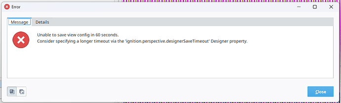

I get this error when trying to save my project. I am using Perspective and the latest changes do not involve any queries. I am not sure I have reached the memory limit with the free trial of Ignition. This is the Error Message I get on the Output Console:
 ![image](https://us1.discourse-cdn.com/inductiveautomation/original/3X/e/d/ed4da4459d6471d2de0c02b3edbd1f8b0e1f4da8.png)

22:54:45.586 [AWT-EventQueue-0] ERROR com.inductiveautomation.ignition.client.util.gui.ErrorUtil -- Unable to save view config in 60 seconds.
    Consider specifying a longer timeout via the 'ignition.perspective.designerSaveTimeout' Designer property.

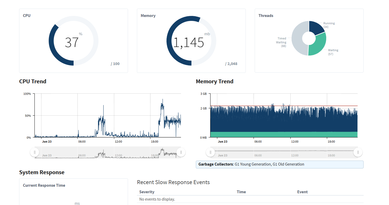

This is what I see on my gateway status. The values of the CPU change fast in the range of (30-70%) and the Memory does the same (700-1450 Mb). I was able to catch one of the spikes:
 ![image](https://us1.discourse-cdn.com/inductiveautomation/original/3X/b/6/b64be7df2fbb5f37600ae61fd5113c196e2e3631.png)
 ![image](https://us1.discourse-cdn.com/inductiveautomation/original/3X/a/2/a200b8ab9cef547df5edae8e04235f9be8dadf34.png)
**Post date:** [June 24, 2025, 7:58am UTC](https://forum.inductiveautomation.com/t/unable-to-save-project/107700/2 "2025-06-24T07:58:06Z")
> [@danny.lazaro](#):
It won't be that. The only limitation on the free trial is the two hour run time. Otherwise it is fully functional.
**Post date:** [June 24, 2025, 10:43am UTC](https://forum.inductiveautomation.com/t/unable-to-save-project/107700/3 "2025-06-24T10:43:07Z")

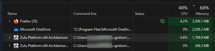

You're out of memory in the designer. You should be able to assign more to it from the gateway settings.
 ![image](https://us1.discourse-cdn.com/inductiveautomation/original/3X/c/f/cf17cb5686ffa785e0d78daa12c41b02bc8d355b.png)

**Post date:** [June 24, 2025, 5:32pm UTC](https://forum.inductiveautomation.com/t/unable-to-save-project/107700/5 "2025-06-24T17:32:23Z")
The 'new'
```python
Is a replacement for the old "View Config is Undefined" message (plus some other improvements in the interop layer that, ideally, would have prevented stuff like this).
For context, when you save changes in Perspective there's a lot going on.
The outer Java application that is the Designer has to 'call in' to the embedded web browser engine running the Perspective session.
That session then has to finalize everything internally, render a preview thumbnail, and report all that back to the outer Java application.
Then the designer has to continue on its way.
That process is _synchronous_, and in 8.1, on the main GUI thread - meaning that if it takes a long time, the whole designer will appear to have crashed. _That's_ why the default timeout is only 60 seconds - so that even in Perspective is having issues the whole designer isn't dead indefinitely. We've never really had much luck replicating the issues people report with saving resources internally, but we're always trying to improve the experience.
I'd really encourage anyone with issues here to make a formal report in to our support department - that's our best way to track these issues and collect data that'll help us fix it.

> [@Unable to Save Project](https://forum.inductiveautomation.com/t/unable-to-save-project/107700/3):
