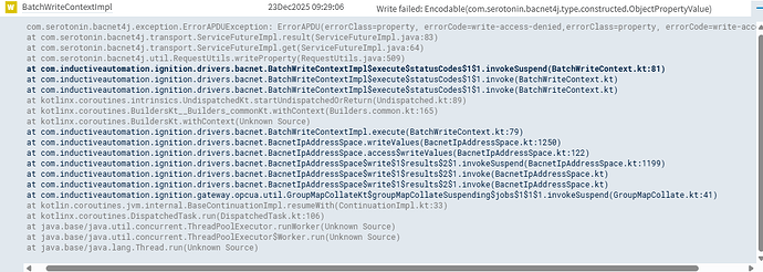

From the logs I see:
 ![image](https://us1.discourse-cdn.com/inductiveautomation/original/3X/7/e/7ebc1696c62aade17e3733f145b366c7ab693b1d.png)

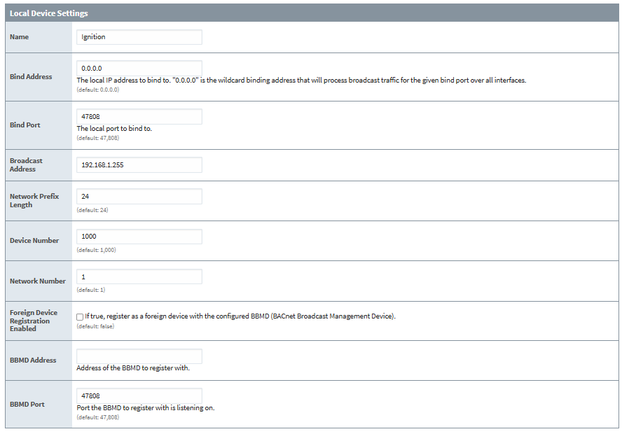

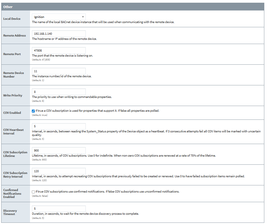

This is how I’ve set up the Local and remote Bacnet devices on the gateway:
 ![image](https://us1.discourse-cdn.com/inductiveautomation/original/3X/1/7/17383e8e08bbf2ef6eb015b8d25d3c740f23f99f.png)
 ![image](https://us1.discourse-cdn.com/inductiveautomation/original/3X/9/0/901769c37c65bc1d00839784cc4111dd52d4ec41.png)
Any help would be appreciated. Thank you!
**Post date:** [December 23, 2025, 2:48pm UTC](https://forum.inductiveautomation.com/t/unable-to-write-to-niagara-via-bacnet-ip/112965/2 "2025-12-23T14:48:40Z")
That error indicates that the **device** sent the access denied error. I would look in your device's settings.
**Post date:** [December 23, 2025, 3:24pm UTC](https://forum.inductiveautomation.com/t/unable-to-write-to-niagara-via-bacnet-ip/112965/3 "2025-12-23T15:24:30Z")
As Phil said, the device is responding with `write-access-denied`.

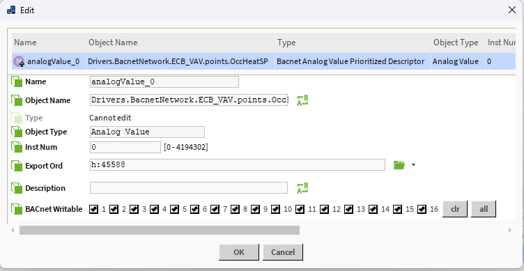

What kind of Object is this Present\_Value property on?
**Author:** ![garrett.nerone](https://avatars.discourse-cdn.com/v4/letter/g/50afbb/32.png) [@garrett.nerone](https://forum.inductiveautomation.com/u/garrett.nerone)\
**Post date:** [December 23, 2025, 4:00pm UTC](https://forum.inductiveautomation.com/t/unable-to-write-to-niagara-via-bacnet-ip/112965/4 "2025-12-23T16:00:01Z")
It’s a Bacnet Analog Value. I have igntion writing on priority 8 (have tried others) and ensured that the Bacnet role is set up properly in niagara. I’ve tried writing to it from other bacnet clients and having the same issue, so my problem is likely isolated to niagara
