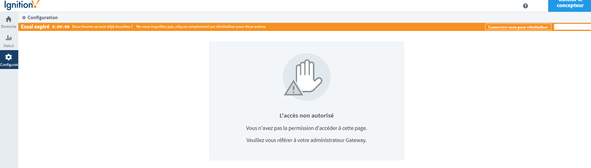

Hello, yesterday I edited something on the web about project setup on user source. And since then, I no longer have access. I can no longer log in with the admin IDs.
I can connect to the designer with the admin credentials but on the web, I no longer have access see the image below

Have you tried restarting the gateway?

when I try, I get : access denied

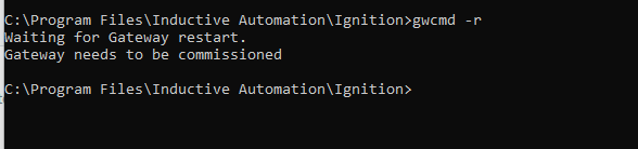

When attempting the restart, are you running the `gwcmd -r` command from a command prompt, and did you right click and select 'Run as Administrator' as administrator when opening the command prompt?

Thank you it work
