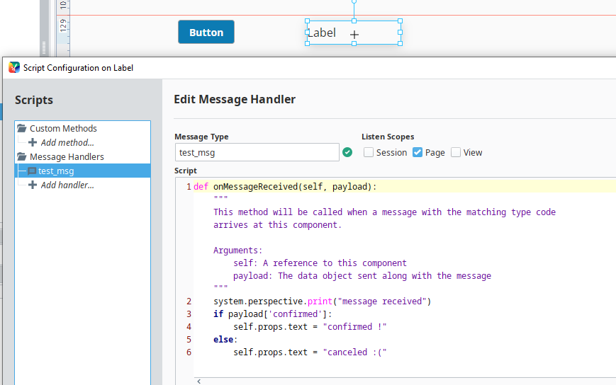

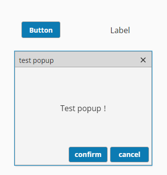

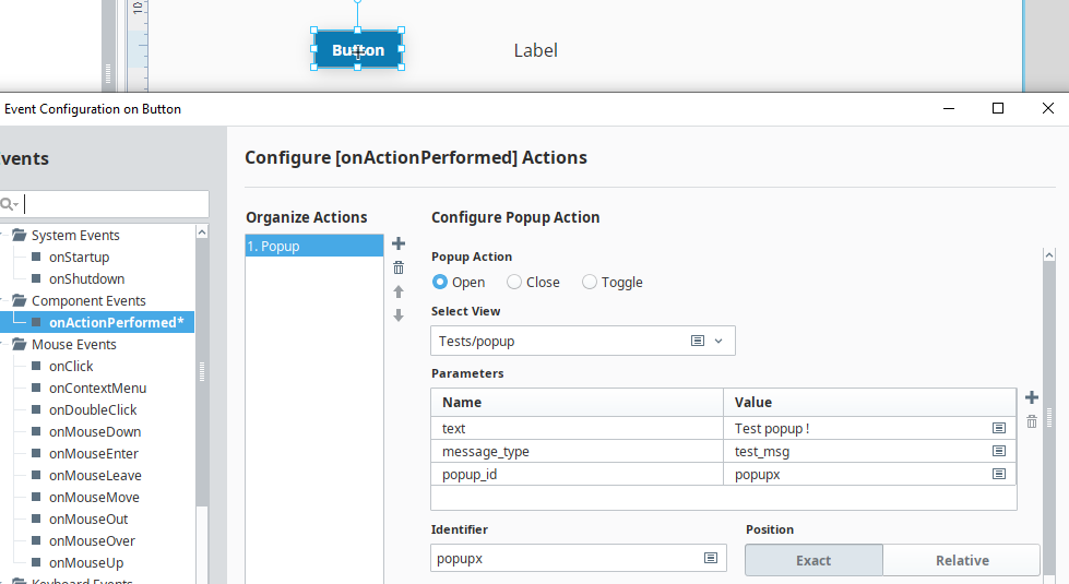

It takes 3 parameters:
`popup_id`: The id you give to your popup when you open it. It’s used to close it, and it’s also sent in the message payload. Should not be needed, but just in case you have several popups opened and you want to identify where a message came from.
`message_type`: Use the same message type for your handler on the table
`text`: That’s displayed in the popup.
To use it, pass those parameters to your popup when you open it:
 ![image](https://us1.discourse-cdn.com/inductiveautomation/original/3X/8/5/85be1eac48a29d3739d81da157c52f1c3a1a8e0b.png)
then add a handler on a component:
 ![image](https://us1.discourse-cdn.com/inductiveautomation/original/3X/f/a/fa788c4053caee36842bb44f185fab3b7203f652.png)
And that’s it.
 ![image](https://us1.discourse-cdn.com/inductiveautomation/original/3X/b/1/b1533901732b6ac718142e81ac2432a71282acb7.png) \> ![image](https://us1.discourse-cdn.com/inductiveautomation/original/3X/5/a/5ab7e78067298c8ac348b4c0bd16e1cd74b3044b.png)
You might need to adjust the scope of the message/handler (which you could also parameterize), and of course style/resize/whatever the popup, but the functionality should be enough for what you’re trying to do.
