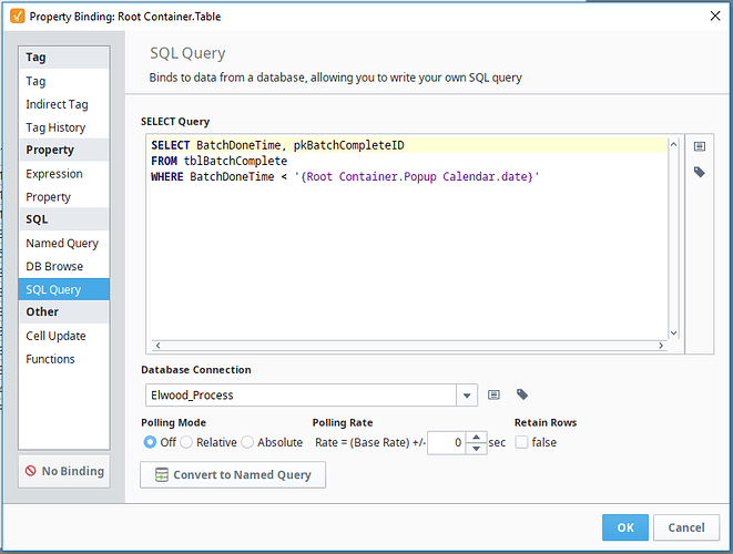

Try placing single quotes around the reference to the date. I threw together a sample to demonstrate, this works:
 ![image](https://us1.discourse-cdn.com/inductiveautomation/original/3X/b/c/bc5651442533200ef595c89a04793a52b5245861.png)
 ![image](https://us1.discourse-cdn.com/inductiveautomation/original/3X/3/d/3d5bdb22d5637d707ee9259939c39302b7fa15ea.png)
