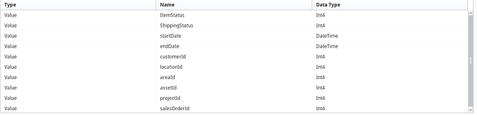

# Upgraded from 8.1.17 to 8.1.26, now Named Query issue - cannot set parameter at position 1 (values was -1)
**URL:** <https://forum.inductiveautomation.com/t/upgraded-from-8-1-17-to-8-1-26-now-named-query-issue-cannot-set-parameter-at-position-1-values-was-1/72569>\
**Tags:** vision, ignition81\
**Created:** [April 18, 2023, 12:32pm UTC](https://forum.inductiveautomation.com/t/upgraded-from-8-1-17-to-8-1-26-now-named-query-issue-cannot-set-parameter-at-position-1-values-was-1/72569 "2023-04-18T12:32:55Z")\
**Posts on this page:** 19\
**Author:** ![bkarabinchak.psi](https://sea1.discourse-cdn.com/inductiveautomation/user_avatar/forum.inductiveautomation.com/bkarabinchak.psi/32/83567_2.png) [@bkarabinchak.psi](https://forum.inductiveautomation.com/u/bkarabinchak.psi)\
**Post date:** [April 18, 2023, 12:32pm UTC](https://forum.inductiveautomation.com/t/upgraded-from-8-1-17-to-8-1-26-now-named-query-issue-cannot-set-parameter-at-position-1-values-was-1/72569/1 "2023-04-18T12:32:56Z")
Was trying to upgrade my gateway from 8.1.17 to 8.1.26 but it caused many of my `SELECT` Named Queries to break with the above error. Here's a singular example stack trace

And the named query definition - all parameters are used in the `WHERE` clause for filtering -

with the parameters -
 ![image](https://us1.discourse-cdn.com/inductiveautomation/original/3X/e/4/e409322e422631ed8d8f64dc343f42e5900c29e8.png)
Is it really just a singular parameter that is causing the issue (the one at position 1 - ItemStatus or ShippingStatus?) or is there something with the structure of my NQ that is no longer acceptable in 8.1.26?

I was able to remedy the issue by deleting all the parameters and recreating them.
Version: 8.1.30
