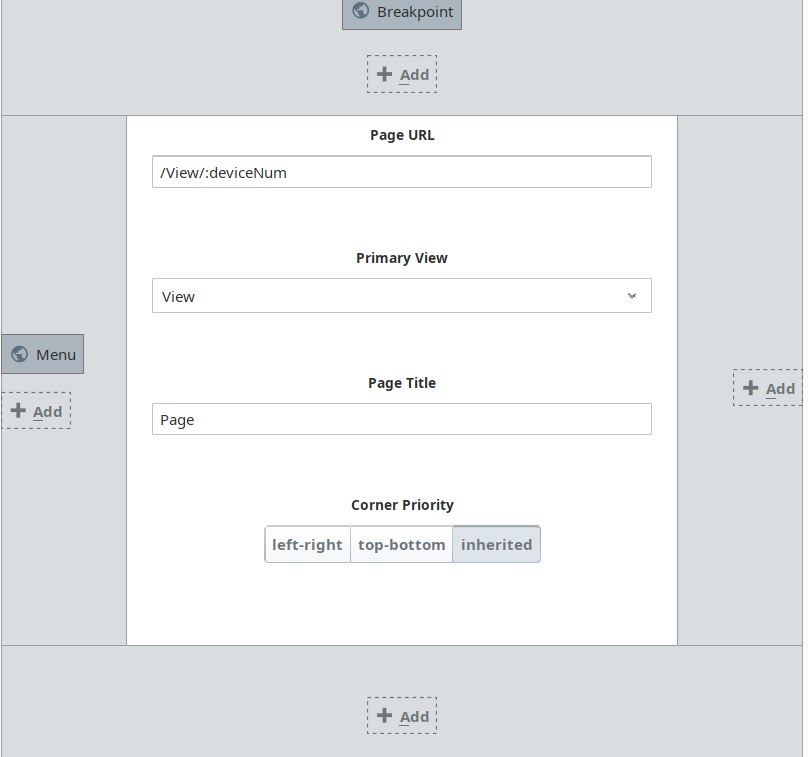

Page:

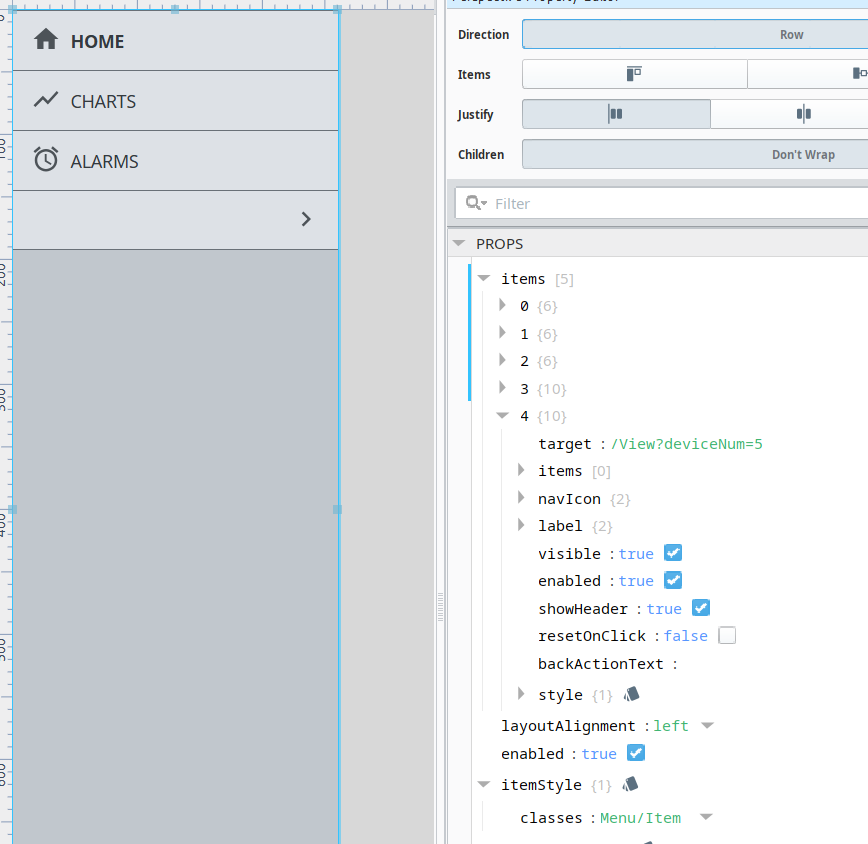

Menu and target
 ![image](https://us1.discourse-cdn.com/inductiveautomation/original/3X/1/3/13f12c8851b3216ce13a13ce08dc27400a80a772.png)

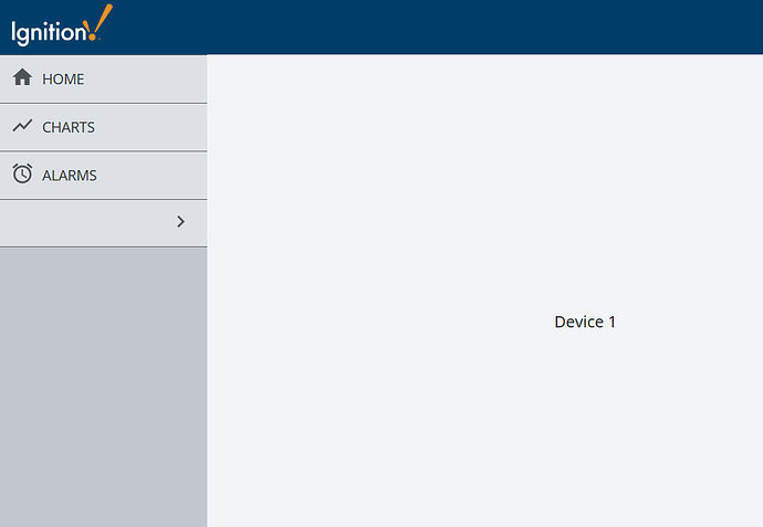

result (url is localhost:8088/data/perspective/client/project/View?deviceNum=5 ) :
 ![image](https://us1.discourse-cdn.com/inductiveautomation/original/3X/e/f/ef7845de29a754bf7f40ff87777092b5fb1cfef3.png)
What am I missing? I tried to follow the doc
**Author:** ![kvane](https://sea1.discourse-cdn.com/inductiveautomation/user_avatar/forum.inductiveautomation.com/kvane/32/22228_2.png) [@kvane](https://forum.inductiveautomation.com/u/kvane)\
**Post date:** [October 20, 2025, 7:25pm UTC](https://forum.inductiveautomation.com/t/url-parameters-not-working/111606/2 "2025-10-20T19:25:59Z")
The ? is not needed in a standard Page URL
Instead of "?deviceNum=5" , replace it with "/5"
> **[Pages in Perspective | Ignition User Manual](https://www.docs.inductiveautomation.com/docs/8.1/ignition-modules/perspective/pages-in-perspective)**
> Pages are the main method of navigation in Perspective. When talking about pages, there are two distinct objects to be aware of.
The ? only comes up if you are treating it as query params (link from the UM):
> **[When Should You Use Path Variable and Query Parameter?](https://medium.com/@fullsour/when-should-you-use-path-variable-and-query-parameter-a346790e8a6d)**
> In this article, I’d like to show you what is a Path Variable and Query Parameter. And how you think and use those as best practice.
