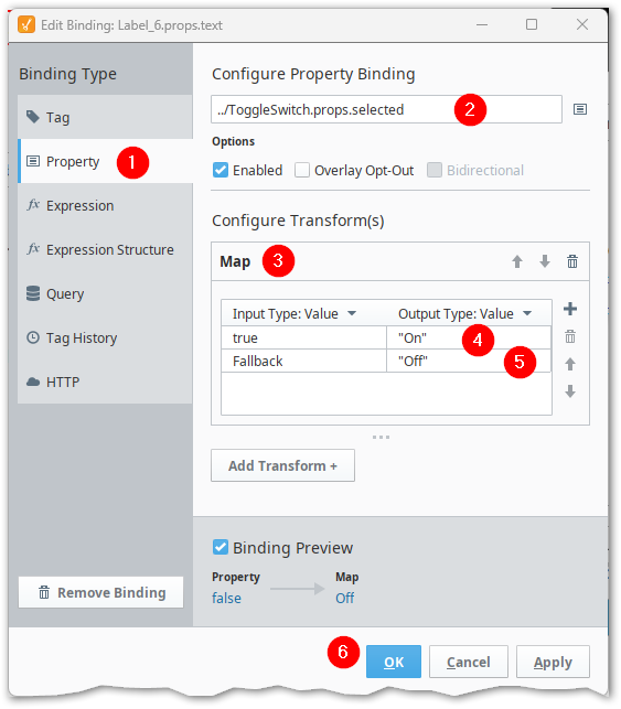

Looking for a way to use a Boolean tag and have it display on or off and replace the true or false text.

**Post date:** [March 2, 2024, 8:25pm UTC](https://forum.inductiveautomation.com/t/use-a-label-to-display-a-boolean-tag-on-or-off-in-prospective/86725/3 "2024-03-02T20:25:09Z")
Since your recent questions have been on Perspective then ...
You should use a Label component to display the status - not a Text Area or Text Field component.
- Bind the label's text property to the boolean property to be displayed (using a Property binding).
- Create a Map Transform on the result to convert True / False to On / Off.
 ![On Off binding](https://us1.discourse-cdn.com/inductiveautomation/original/3X/3/a/3ac6e6005c1a35b2c6466e857d7e315291ca9dbf.png)
Result:
![On Off label](https://us1.discourse-cdn.com/inductiveautomation/original/3X/1/6/16347d67cf07f77de399ca2ffbb44ed66d4df333.gif)
(Please do fix your question title.)

That worked thank you.

The prop binding/transform will work perfectly well, but an expression is supposedly more performant:
```auto
if({../ToggleSwitch.props.selected}, "On", "Off")
