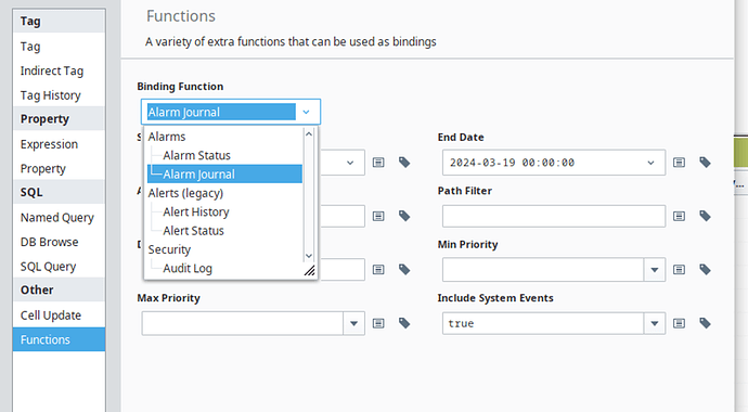

Hello, I have a question:
I'am using `system.alarm.queryStatus`(endDate = end,displaypath=["\*pump 1 \*"]
But instead of showing me all alarm (states) events, it only displays the first 10 in a table. Is this normal?
What is difference between `system.alarm.queryJournal` and `system.alarm.queryStatus`
I see doc but I didn't understand.

queryStatus is for live alarms, queryJournal is for history of alarms.

 ![image](https://us1.discourse-cdn.com/inductiveautomation/original/3X/9/1/91b16ca23020024b82d9b76ead7501c8054132c8.png)
if I don't want use a script, it mean ?
`system.alarm.queryJournal` = `Alarm journal` Binding function
`system.alarm.queryStatus` = `Alarm status` Binding function

Yes just different way of getting to the data.
Status is for the live view of alarms and their states.
Journal queries against the Alarm Journal that you configure on the gateway web interface.
