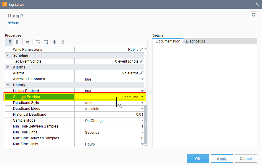

I have a float tag in a UDT, I want to display a time series chart in perspective with this tag. I configured the component series/data/Tag History with the tag, and make sure the tag HistoryEnabled bit is true, But the time series chart display me a graph of zero (which is not what I can see from the tag browser). is there anything I missing for configuration? Thanks!

It sounds like you need to specify a storage provider for the tag upon which you’ve enabled tag history. It can look like it’s configured correctly without the provider specified, but you won’t get any data if that’s the case:
 ![image](https://us1.discourse-cdn.com/inductiveautomation/original/3X/a/0/a0a25e208e06a1d8879d9d341614be3f61e6aa30.png)
