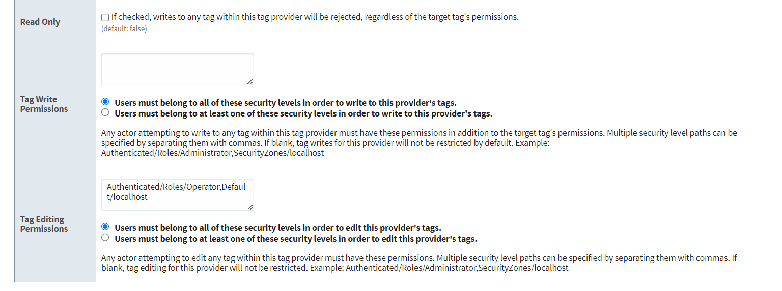

Defined the operator role for tag editing.I also tried with this path. **(Authenticated/Roles/Operator,SecurityZones/localhost)**

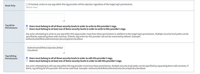

There may be a typo issue with your roles. In your Tag Editing Permissions, you have Authenticated/Roles/Operator with a big O.

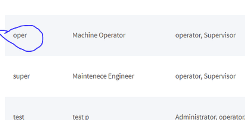

 ![image](https://us1.discourse-cdn.com/inductiveautomation/original/3X/f/9/f9ff51cae5bcaf4bdbec0e6dff6c974b52b693ba.png)
I would first take a look at these and make any corrections before trying to move forward.
**Author:** ![Govind\_Suthar1](https://avatars.discourse-cdn.com/v4/letter/g/a87d85/32.png) [@Govind\_Suthar1](https://forum.inductiveautomation.com/u/Govind_Suthar1)\
**Post date:** [January 24, 2024, 5:23am UTC](https://forum.inductiveautomation.com/t/user-credentials-in-the-tag-edition-permission-issue/84093/3 "2024-01-24T05:23:12Z")
Hi kbarrett,
Yes, I already do that and it's worked. thanks for the reply.
