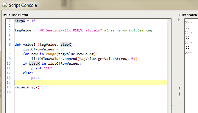

I am testing my function on the Script Console and it works:
(however if I use this code as a function on a Share Script, it doesn’t work)
 ![](https://us1.discourse-cdn.com/inductiveautomation/original/2X/a/a16799c11735e438af72dd47c7485bc40939bc01.png)

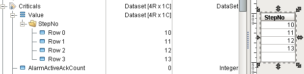

I am using a Dataset Memory tag (called "Criticals"which has one column and 4 rows as one input, and an integer Memory tag as another input (called “Value”). My goal is that if the Values is in the list of Criticals, I would just write a string on string (“CC”) on a Memory Tag.
The Dataset tag has 1 column and 4 rows with 4 values:
 ![](https://us1.discourse-cdn.com/inductiveautomation/original/2X/9/93e45a689c48342f0bbed0ad847036fb03fdacea.png)

In the global scope (ie, from an expression tag) you need to qualify your tag path:
`[realtime tag provider]path/to/tag`.
Most likely, the name of the realtime tag provider you’re using is just `[default]`. There’s no harm to qualifying tagpaths in the client scope, either, so just changing that in your shared script should be sufficient.
**Author:** ![Lalillo1](https://avatars.discourse-cdn.com/v4/letter/l/a6a055/32.png) [@Lalillo1](https://forum.inductiveautomation.com/u/Lalillo1)\
**Post date:** [September 27, 2018, 1:47am UTC](https://forum.inductiveautomation.com/t/using-a-dataset-tag-as-a-function-definition-on-shared-script/19825/3 "2018-09-27T01:47:33Z")
Thank you very much. I also have to give credit to Tyler from Inductive Automation technical support who replied me on this one. All I had to do is change the format on my expression tag to this one:
`runScript("shared.FindValue.valueIn",0,{[.]DatasetTag},{[.]Value})`
Basically, using the optional “args” parameter for runScript().
