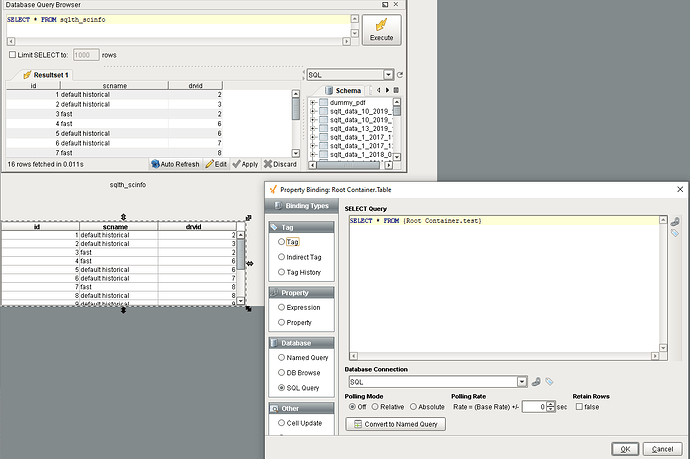

I’m using trying to use the following query as the data binding for a table. It works great until I try to use a custom property (which is a string) as the table name. Does anyone know what the correct syntax is to do this? Tried searching but no luck. Thanks!
SELECT T\_Stamp, BatchID
FROM ‘{Root Container.MySQL\_Table}’
ORDER BY t\_stamp DESC

> [@rupej](#):
Try:
```auto
SELECT T_Stamp, BatchID
FROM {Root Container.MySQL_Table}
ORDER BY t_stamp DESC
Tip: using the 'paperclip' icon (insert property value), top right of data binding popup, will create it with the correct syntax

Thanks Matrix,
I did use the paperclip and it generated the syntax without the quotes. That didn’t work, so the quotes were a guess on my part. Double quotes didn’t work either. Any ideas?

I’m a bit unsure what you’re actually trying to achieve here.
Grab a label, place it on the same window, and bind the text property to {Root Container.MySQL\_Table}
Make sure what is displayed on the label equals what you have “when it was working, before you made it dynamic”
I seem to recall that you can’t dynamically use a table name, let me check that

![binding](https://us1.discourse-cdn.com/inductiveautomation/original/2X/3/3effc8eb51165d7e62147d891404280e73b647a4.png)
No issues here, it was the column name that can be tricky dynamically (best to use named queries for that)

Welp, I removed the quotes and now it’s working… even though it wasn’t before? I must have changed something between then and now. Thanks for verifying that the drag-and drop worked for you- that made me try removing the quotes again! 👍
