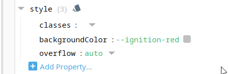

Hello,
I feel I am so frustratingly close to solving this. I’ve enabled stylesheet.css in my project where I want to declare some color variables to reuse. I don’t have access to the themes or colors css (large organization, I have to stay contained in this project). I’d like to be able to use my variables as we do with theme colors but its just not working.
Here is my stylesheet.css
```css
:root{
	--ignition-red:'#DA291C';
and when I try to reference it in fields, its just not picking it up.
 ![image](https://us1.discourse-cdn.com/inductiveautomation/original/3X/9/6/9626087fc1187d31395845c099e1631622a7167c.png)
I’ve tried as many flavors as I can think of, like wrapping it in var(), popping the variable out of :root, etc. and its just not working. I feel like I’m very close.
Any help getting me over the finish line would be much appreciated.
Thanks

Are you testing it in your designer or in a separate browser? Var(—variable) should work, but it will not work in designer. When you save the project and test in a browser it will work correctly.
**Author:** ![weston.forbes](https://avatars.discourse-cdn.com/v4/letter/w/c57346/32.png) [@weston.forbes](https://forum.inductiveautomation.com/u/weston.forbes)\
**Post date:** [October 2, 2025, 1:21pm UTC](https://forum.inductiveautomation.com/t/using-css-variables-declared-in-stylesheet-css-elsewhere-in-perspective/111155/3 "2025-10-02T13:21:20Z")
son-of-ah… I swear I tried that. Its working now. Once I closed designer and reopened it, it also shows in designer. I think I just got so topsy-turvy trying everything. Thank you for your help.

Pretty sure you have to save changes to the stylesheet before they take effect in designer too, and yes, no quotes around the hex colour (or hsla() colour, if you're human!)
