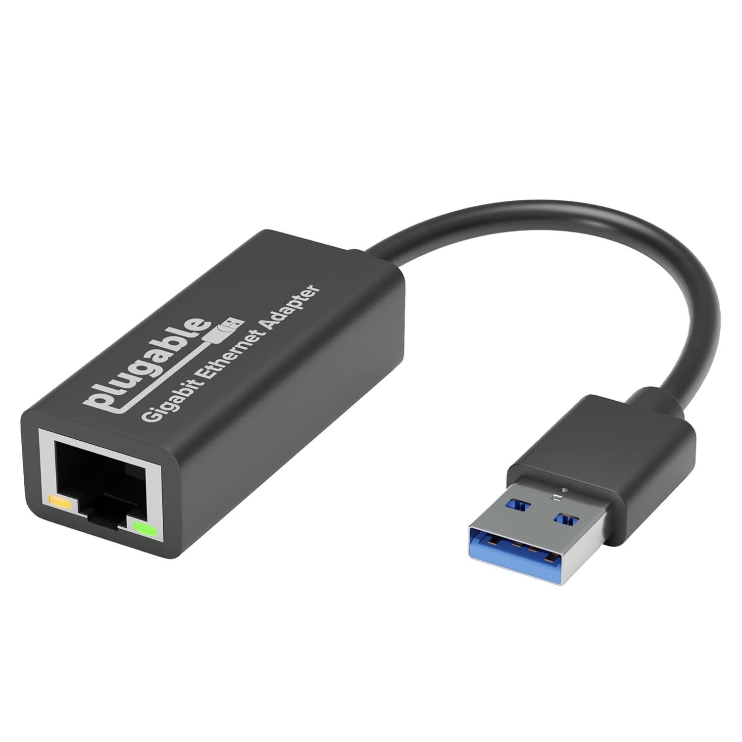

**Author:** ![PRAMANJ](https://sea1.discourse-cdn.com/inductiveautomation/user_avatar/forum.inductiveautomation.com/pramanj/32/66935_2.png) [@PRAMANJ](https://forum.inductiveautomation.com/u/PRAMANJ)\
**Post date:** [September 3, 2018, 6:43am UTC](https://forum.inductiveautomation.com/t/using-dlls-in-java-code/19501/6 "2018-09-03T06:43:52Z")
there are USB to Ethernet converted devices available that can be use as interface I guess.
> **[Plugable USB 3.0 to 10/100/1000 Gigabit Ethernet LAN Network Adapter - Buy...](https://www.amazon.in/Plugable-Gigabit-Ethernet-Network-Adapter/dp/B00AQM8586)**
> The Plugable USB3-HUB3ME is an easy way to gain wired gigabit Ethernet network speeds for faster HD video streaming, gaming, web browsing, network storage and more while expanding USB connectivity by connecting up to three USB 3.0, 2.0, or 1.1...
