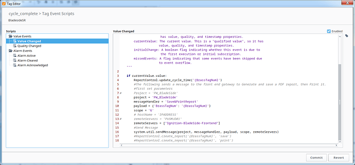

I have a frontend and backend gateway. Frontend contains perspective visuals and reporting modules. Backend contains the tag provider and DB connection. Frontend also has DB connection. Originally this was one gateway where all the scripting was on the one gateway. Now I have some tag event scripts which reside on the backend. I have a script based off of a tag event script which contains a call to save a report however it will not work because the frontend contains the report and the backend contains the tag calling the script. Whats the best way and example to complete this from the backend to the frontend? Can I use a message handler? If so can you give an example of what it would look like? I am very new to message handlers to do this type of thing.
Here is the existing tag event script being called from the backend tag:
 ![image](https://us1.discourse-cdn.com/inductiveautomation/original/3X/4/f/4faa75a39c4249eb2f63a99f7242b41a900b42c2.png)

**Post date:** [November 11, 2021, 10:06pm UTC](https://forum.inductiveautomation.com/t/using-message-handler-to-run-script/52818/3 "2021-11-11T22:06:42Z")
Thanks! Here is my attempt of the tag event script.
 ![image](https://us1.discourse-cdn.com/inductiveautomation/original/3X/9/9/99fb5de828942b7d8242f7cedb165ee5908a88dc.png)
Question I have is what to put for the hostName or remoteServers parameters. Would I be able to put the IP address of the gateway connection in one of these? Would I be able to put the gateway name of the frontend gateway which contains the messagehandler in one of these?
Having trouble determining which one to use and what to put for one of them. Thanks.

**Post date:** [November 12, 2021, 4:34am UTC](https://forum.inductiveautomation.com/t/using-message-handler-to-run-script/52818/6 "2021-11-12T04:34:07Z")
Yea I did see it had to be a list. I am pretty sure I have everything correct but still not working.
Backend tag event script is creating the call of the messagehandler on the frontend.
Frontend project is called ‘PW\_BladeSide’, frontend gateway is ‘Ignition-BladeSide-Frontend’.
When cycle\_complete bit goes high it builds the call and then sends out the message.
Here is revised code for tag event script:
 ![image](https://us1.discourse-cdn.com/inductiveautomation/original/3X/d/0/d02fe2eeedf5fa54ddf32fb09226e1c7802614de.png)
The gateway message handler on the frontend is:
 ![image](https://us1.discourse-cdn.com/inductiveautomation/original/3X/1/d/1d1185cc8c368cc2f5d18d7fe2865640709e4269.png)
It is supposed to call ReportControl script in the frontend gateway scripting and execute code that creates a folder if one is not already created, save the report as a pdf and save it in that folder, and also print the report out. It is not even creating the folder.

I am not getting to do anything yet so far…is there anything obvious I am doing wrong as to why its not working?
Also BrassTagNum is a string parameter within the UDT.
**Post date:** [November 12, 2021, 4:37am UTC](https://forum.inductiveautomation.com/t/using-message-handler-to-run-script/52818/7 "2021-11-12T04:37:49Z")
I would try putting some debugging messages into the message handler to see if it’s actually running at all. Add in some print statements or logger traces and check the gateway wrapper log or server logs.
I’m also not sure that `'{BrassTagNum}'` works. I thought in order to use that syntax you needed to use `f'{BrassTagNum}'`, but I don’t think that’s available in Jython2.7. Try replacing with the `'{}'.format(BrassTagNum)` method.
Wait, why do you even need to indirectly reference it? Why not just
`ReportControl.create_report(BrassTagNum, 'save')`?
