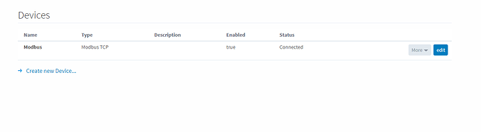

step1:
 ![](https://us1.discourse-cdn.com/inductiveautomation/original/2X/a/af5896f27c7921411e776f56f3922ff3c5eb5d9a.png)

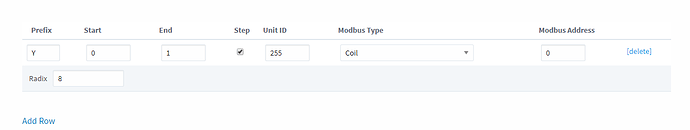

step2:
 ![](https://us1.discourse-cdn.com/inductiveautomation/original/2X/b/b471768652d65229cf6f9ffb6d596431d8fe4f0a.png)

**Post date:** [December 19, 2018, 1:37pm UTC](https://forum.inductiveautomation.com/t/using-modbus-slaver-software-to-test-that-communication-is-normal-and-why-data-cannot-be-displayed-properly/21493/2 "2018-12-19T13:37:26Z")
You need to set the “One-based Addressing” setting to false for that device connection.
It also helps to start without the mapping. Just make an OPC tag in the designer with “[device]255.C0” or “[device]255.C1” as the OPC Item Path.
