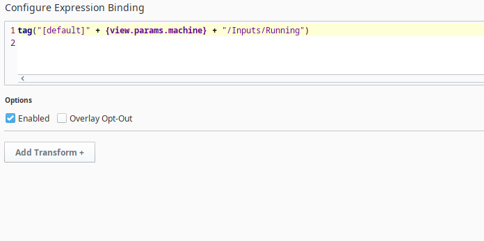

I'm trying to create a template in Perspective (kind of like how they have templates in Vision) using embedded views. I'm trying to get it to where I can have my tag path change based on a parameter so that I don't have to go in and change every single expression whenever I add a new machine.
I want my paths to look something like this: **tag("[default]" + {view.params.machine} + "/Inputs/Running")**
I'm pretty sure the syntax of my path is correct based on what others have done on the forum. I think my error lies in how I'm setting up the parameter in my embedded view.

Avoid the `tag` function like the plague.
Use indirect tag bindings to achieve what you are trying to do.
Can’t help you more without screenshots or actual code, sorry!

Transform your expression binding into an indirect tag binding like so:
 ![image](https://us1.discourse-cdn.com/inductiveautomation/original/3X/8/b/8ba60dea0cc9fa5dab2d9e70a3e92ed47ebd4f72.png)
After doing that, hover over the result of the binding to see what the error could be (where it is written Bad\_NotFound).
EDIT: To achieve what you are trying to do with your last screenshot, consider creating as many custom properties as needed, each of those custom properties should be an indirect tag binding.
**Author:** ![cdelacruz](https://avatars.discourse-cdn.com/v4/letter/c/838e76/32.png) [@cdelacruz](https://forum.inductiveautomation.com/u/cdelacruz)\
**Post date:** [November 20, 2025, 12:41pm UTC](https://forum.inductiveautomation.com/t/using-parameters-in-perspective/112307/5 "2025-11-20T12:41:14Z")
So I got the follow error: Error\_InvalidPathSyntax(“Unable to build tag path, indirection reference(s)[machine] did not produce a value.”)

Show us a screenshot of what you did. Make sure you follow exactly what I did in my screenshot (it is not enough to write {machine} in the tagpath, you have to also specify where this data points to, in this case `{view.params.machine}`)

What is the value of the parameter `view.params.machine`
**Author:** ![Samuel\_Sueur](https://avatars.discourse-cdn.com/v4/letter/s/e36b37/32.png) [@Samuel\_Sueur](https://forum.inductiveautomation.com/u/Samuel_Sueur)\
**Post date:** [November 20, 2025, 12:48pm UTC](https://forum.inductiveautomation.com/t/using-parameters-in-perspective/112307/11 "2025-11-20T12:48:33Z")
Have you defined the `machine` parameters on your view?
This should be done in the definition of the view
See my screenshot on my previous post, on the right hand side, I have defined the param `machine`

I thought I did, I’m going to assume that I did it wrong though. This is what I have:
 ![{CF79D2F9-511B-4650-96A5-C9F35EF20B10}](https://us1.discourse-cdn.com/inductiveautomation/original/3X/2/e/2ec7c8bf966b12145f8eb903fd2b95bbdb4aef17.png)

Here you are embedding your view, you need to also define the params `machine` in your view definition.
You can use this small square to get to your view definition.
![image](https://us1.discourse-cdn.com/inductiveautomation/original/3X/6/c/6c2089dc53f768981bdfadb2d312cdd1805219b4.png)
**Post date:** [November 20, 2025, 1:14pm UTC](https://forum.inductiveautomation.com/t/using-parameters-in-perspective/112307/14 "2025-11-20T13:14:20Z")
That worked for me! Thank you!
