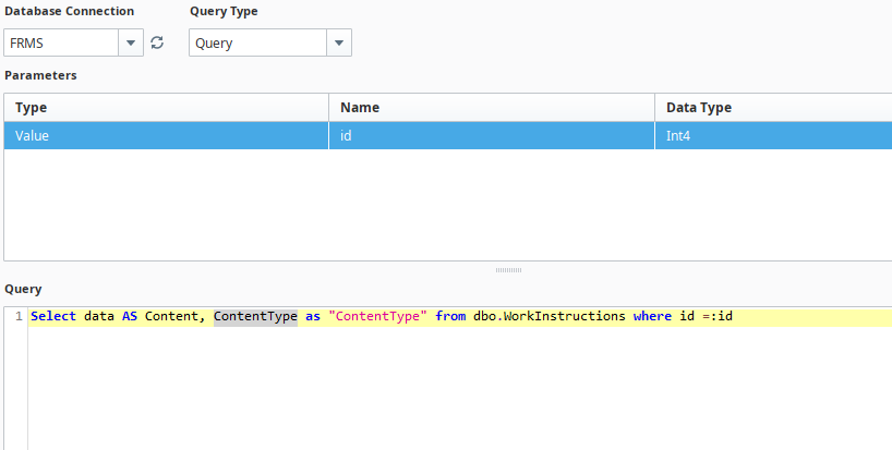

**Author:** ![jkelleyus](https://avatars.discourse-cdn.com/v4/letter/j/3bc359/32.png) [@jkelleyus](https://forum.inductiveautomation.com/u/jkelleyus)\
**Post date:** [May 7, 2024, 1:58pm UTC](https://forum.inductiveautomation.com/t/using-pturmels-blob-module-and-the-perspective-app-on-android/90024/3 "2024-05-07T13:58:51Z")
Morning, Phil. Here's a clip of the query:
 ![java_8dgvbSEpqs](https://us1.discourse-cdn.com/inductiveautomation/original/3X/3/6/36d35a22c1109e16a6371c4ca7a9a94a17786047.png)
**Post date:** [May 7, 2024, 2:00pm UTC](https://forum.inductiveautomation.com/t/using-pturmels-blob-module-and-the-perspective-app-on-android/90024/4 "2024-05-07T14:00:57Z")
Well, PNG files need `image/png`, not `image/jpeg`.
You need another column in your images table to hold the content type from when you upload them.
(Your column name `ContentType` almost certainly needs double quotes, not single quotes. Column names are identifiers, not values.)
