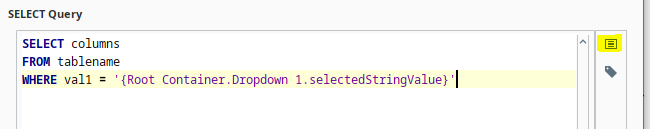

Use the property browser to get the path.

> [@dkhayes117](#):
> to get the path.
But don't leave it as a basic query. Convert it to a Named Query, as curly-brace interpolation is **unsafe**.
**Post date:** [December 2, 2025, 5:56pm UTC](https://forum.inductiveautomation.com/t/using-value-from-one-dropdown-to-query-values-for-another-dropdown/112573/4 "2025-12-02T17:56:52Z")
How did you define the named query? The parameter in the query, must match the name of the parameter as defined in the named query.
A named query will not recognize a vision component path.
Once you have the named query, you can create a named query binding. Selecting the path to your named query, will then populate the parameters table with the parameters defined in the named query. You can then use the property browser in the value column of that table to bind the selected value of the dropdown to the parameter.

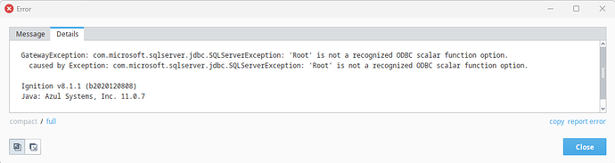

This works if I bind from the Property Editor at the Data property.
However, if I copy and paste the SQL command into a Named Query, it doesn’t work.
I get an error.

Right, named queries are different. Parameterize the variable in the query like @lrose is speaking to above.

Ok, got it working now. Just had to hit the easy button and select the ‘Convert to Named Query’ in the property binding window instead of going to the actual Named Query in the Browser and creating from scratch, like how pturmel mentioned.
