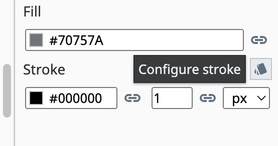

The Drawing Editor seems to be missing the UI for a dashed array
e.g. (from Inkscape)
 ![image](https://us1.discourse-cdn.com/inductiveautomation/original/3X/d/7/d7e73c7426724c235fd3103180edf9b78ce21af1.png)
**Author:** ![hpark](https://sea1.discourse-cdn.com/inductiveautomation/user_avatar/forum.inductiveautomation.com/hpark/32/21222_2.png) [@hpark](https://forum.inductiveautomation.com/u/hpark)\
**Post date:** [October 13, 2025, 2:41pm UTC](https://forum.inductiveautomation.com/t/v8-3-drawing-editor-missing-line-dash-array-ui/111381/2 "2025-10-13T14:41:13Z")
Hi Nick!
The dashed line properties can be configured through the Configure Stroke option (click on the Style icon), where you'll find the Dash Array setting.
 ![Screenshot 2025-10-13 at 7.36.36 AM](https://us1.discourse-cdn.com/inductiveautomation/original/3X/d/b/dbb6fae24d15289fc8a4c0a826d9a51e7b66b53b.png)
