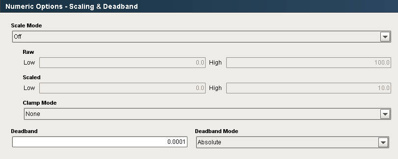

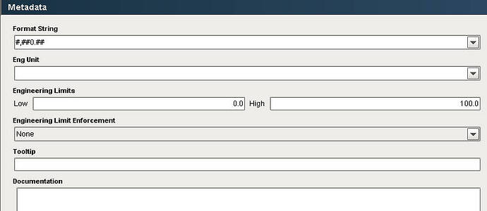

Hi，I have a issue that: when a floating number changes, then stores the new value to database, but in the database, i found many records, the same tag, different time, small changes in floating point numbers;
So, how to stop it?

Increase Deadband
**Post date:** [January 10, 2022, 2:05pm UTC](https://forum.inductiveautomation.com/t/value-changed-store-to-db/54818/3 "2022-01-10T14:05:32Z")
With a format string that shows no more than two decimal places, your deadband should not be smaller than 0.01.
